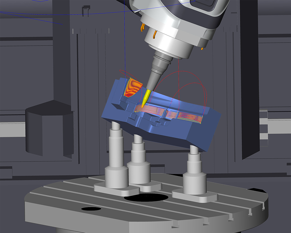

hyperMILL® VIRTUAL Machining Optimizer now detects violations of the axis limitations and optimizes movement sequences accordingly.

hyperMILL® Virtual Machining NC code-based machine simulation has been enhanced, too. Within the Virtual Machining Optimizer module, which links individual part programs with smooth and safe connections, the cutter is able to remain close to the workpiece, violations of the axis limitations are detected, and movement sequences are optimized accordingly. There also iso a new option in Virtual Machining to apply a special approach and retract strategy to machines where the cutting tool can be retracted into a tunnel.
