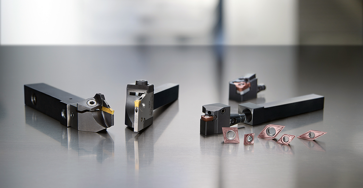

The Seco QC Modular Toolholder lets users remove both cutting heads and inserts as a single assembly, quickly indexing them, and reinstalling them.
SECO TOOLS LLC introduced a modular toolholder system for manufacturers seeking to improve productivity with Swiss-style machining. The system allows fast, easy and repeatable insert indexing and tool changes outside of tight machine work spaces. The QC (Quick-Change) Toolholders also feature Seco Jetstream Tooling® and Jetstream Tooling® Duo technology for optimal chip control, high-quality surface finishes and extended tool life.
The Seco QC Modular Toolholder lets users remove both cutting heads and inserts as a single assembly, quickly indexing them, and reinstalling them. Manufacturers also may use this system to exchange cutting heads and inserts with a second set for even greater efficiency.
The QC cutting head features double carbide pins for accurate, consistent, and secure insert mounting and indexing.
Seco Jetstream Tooling® technology directs high-pressure coolant precisely through the QC Toolholder to the cutting zone.
Seco Jetstream Tooling® Duo, available on a selection of cutting heads, adds a second coolant channel to the underside of the holder. The second coolant channel can be switched off if needed for even more versatile machining.
The new QC Toolholders include cutting heads for general ISO turning, MDT, threading and parting-off. Shanks are available in metric sizes of 10 mm, 12 mm, and 16 mm, and inch sizes of 0.375 in., 0.500 in., and 0.625in.
