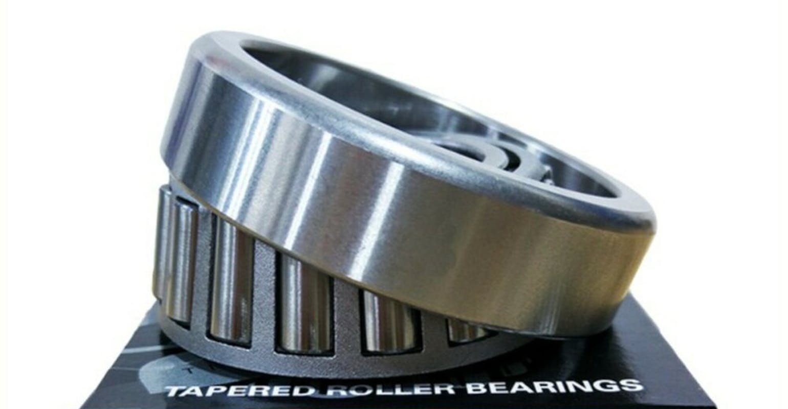

Understanding TRB speed ratings
The speed rating of any bearing is relative to its size, and is inversely proportional, i.e., the larger the bearing size, the lower the speed rating. Tapered roller bearings (TRB) are no exception to this rule. However, the method of characterizing the speed is different from other bearing types.
To take the bearing size out of the equation, an equation has been developed to normalize the speed based on the size of the bearing. This is done for ACBBs and CRBs using the dN value that is equal to the bearing bore in millimeters multiplied by the speed and RPM. A bearing with a 10-mm bore running at 100,000 rpm will have the same dN value as a bearing with a 1,000-mm bore running at 1,000 rpm: both are equal to 1,000,000 dN. Speed guidelines are based on dN, not RPM.
TRB's speed guidelines are based on the rib speed of the bearing, not the dN value. The rib speed is simply the linear velocity of the elliptical rib-roller contact. It is calculated using the midpoint of contact between the roller large end and cone rib, Dm, and the bearing speed in RPM (see Figure 1.) Dm value can be scaled from a drawing or approximated as the average of the bearing bore and OD.
When the rib speed begins to approach 5 meters per second (1,000 fpm) the heat generation can become significant. If the heat cannot be removed efficiently, it can result in the breakdown or loss of the lubrication film and cause surface-initiated damage that can significantly reduce the spindle’s performance and service life. Timken provides speed guidelines for 2TS-IM spindles using grease or oil for rib speeds up to 4,000 fpm (20 m/s; see Table 1.)
There are no clear-cut speed limitations for TRBs since it depends on the bearing design and lubrication system. The guidelines provided in Table 1 are based on typical industrial experiences relating to speed and temperature for various types of lubricating systems for optimized bearings and spindle configurations. Testing is always recommended for all new high-speed applications.

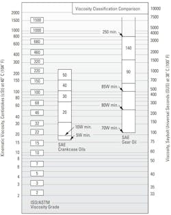

When selecting a lube oil, it is important to know that there are several classifications of oils based on viscosity grades. The most familiar are the Society of Automotive Engineers (SAE) classifications for automotive engine and gear oils. The American Society for Testing and Materials (ASTM) and the International Organization for Standardization (ISO) have adopted standard viscosity grades for industrial fluids. Figure 2 shows the viscosity comparisons of ISO/ASTM with SAE classification systems at 40° C (100° F.)
The lube oil is typically selected based on its viscosity, or resistance to shear/flow. Higher viscosity oils produce a “thicker” film that separates the raceways and rollers during operation and help to prevent metal-on-metal contact that leads to surface-initiated damage of the bearing.
However, increasing the oil viscosity also increases the heat generation from the bearing, which increased the torque/drag and operating temperature. It is necessary to select an oil with a viscosity that balances these two diametrically opposing characteristics.
Machine tool spindles contain precision-class bearings with finely honed rollers and races. This results in very low surface roughness (small asperities) that require a thinner separating film compared to a standard-class bearing. This results in a lower viscosity requirement for the lube oil. An oil with an ISO viscosity grade of VG10 to VG32 is common for TRB spindles that run at rib speeds greater than 2,000 fpm (10 m/s), while slower spindles with higher loads may be as high as a VG46 to VG68. Analysis of the spindle is the best way to determine the correct viscosity grade.
