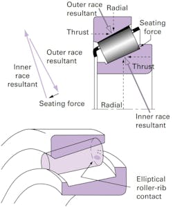

Basic design and operation of TRBs. TRBs exhibit true rolling motion of the rollers on the raceways due to their “on apex” design. The allows for the bearing to run cooler with improved stiffness and accuracy, as shown in Figure 1A.
The true rolling motion is the result of two design features, the taper of the roller and the contact between the spherical surface ground on the large end of the roller and the race rib. When two, single-row TRBs are mounted indirectly as shown in Figure 1B, the optimal spread is when their apexes intersect the shaft centerline at the same location.
The result is no relative slip between the rollers and raceways ensuring that the surface speeds of the roller and raceways are the same at every point along the roller body. The tapered body of the roller also generates a seating force between the spherical end and the race rib that prevents the rollers from skewing, as shown in Figure 2.
