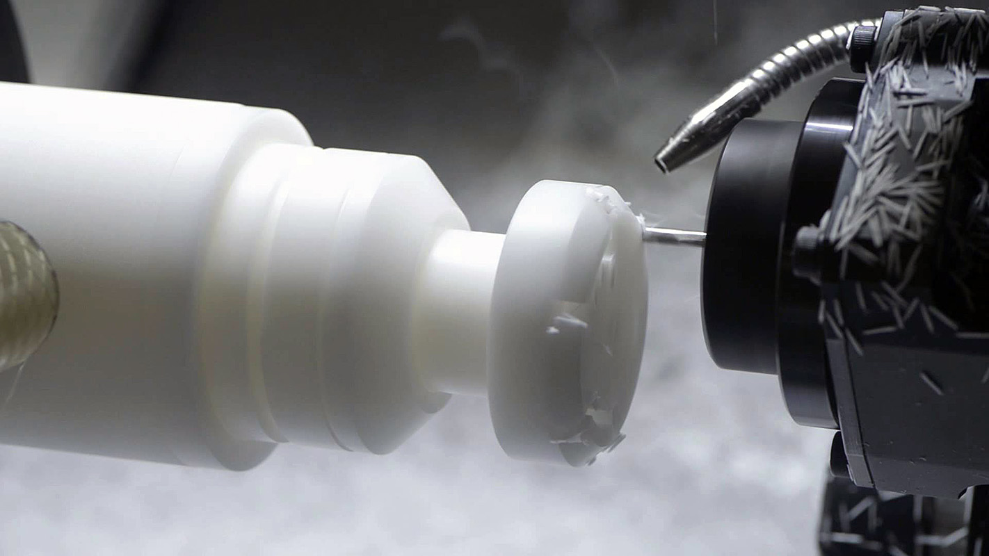

Tips for machining PTFE parts — Machining parts from PTFE does not differ significantly from manufacturing parts from other materials, with some minor exceptions:
•  Unbalanced or bowl- or disc-shaped elements aren't a good fit for machining from PTFE.
•  Some detailed projects, or parts with exceptionally tight tolerances, might require a different material.
•  When placed under extreme pressure in specific environments where different materials meet, such as mechanical joints, PTFE can lose its shape. Consider the applications carefully, including the stresses placed on moving components.
•  High-quality finishing options for plastics already are somewhat limited, compared with metals, but PTFE has an even lower tolerance to finishing.
