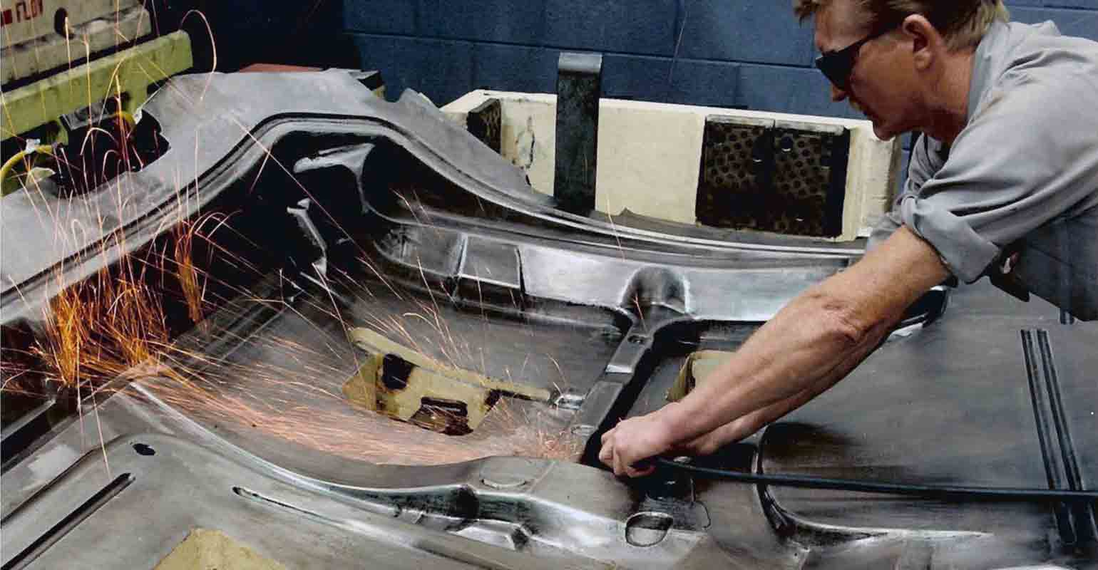

Cracked Dies — Dies are a common feature of metal forming operations, so when they start stretching, cracking or splitting, it's definitely a problem. What can cause hard steel tools to stretch and crack? “This is a function of selecting the correct tool material and is related to the girth of the tool,” said Dave Hoover, technical advisor at DIE-TECH, Inc.
A problem with a die is usually first indicated by what is known as necking — a stretch mark in the metal that shows it has exceeded its capabilities but hasn't yet failed to the point of a full rupture.  Necking is often the only visible sign that there’s a problem with the die before the metal fails entirely and ruptures.
A cracked die may be caused by a number of factors, including temperature changes in the manufacturing process, additional stress placed on the die or any number of other variables. Hoover stated, “[O]ne must be sure the force of the tool hitting the raw material is straight down, not being applied at an angle.”
The most important action is to regularly inspect your dies for any sign of wear. If you start to see signs of this wear and stretching, it's time to inspect the rest of the production line to see what’s causing the problem. “If you discover consistent failure of a portion of a die, you need to redesign the tools by increasing their girth or selecting a different tooling steel,” he added
