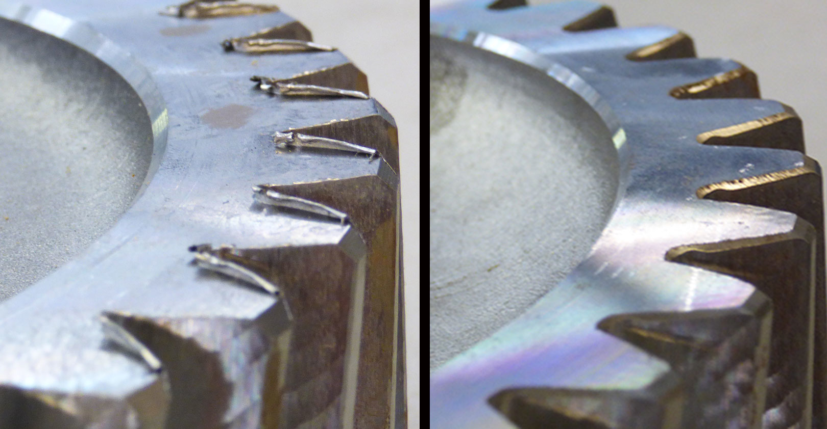

Before
After
"For this part, we're trying to stay under 8/1000 of an inch  edge break," says Mutschler as he displays one bulky helical gear. "Anything more than that would be an issue for the surface contact of the chain."

"Parts may look good on Monday morning, but by Friday afternoon they have spurs all over them," Mutschler says. He adds that human error can deburr too much, ruining the part and costing time and money.
