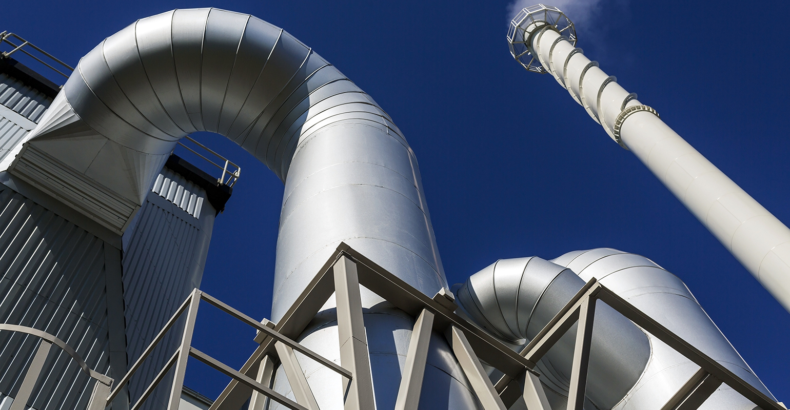

industrial co-gen plant

Internal combustion engine-powered generators fueled by natural gas are steadily growing gaining importance for manufacturers and electric utilities, both domestically and abroad, as they employ on-site power production machinery that is efficient and more environmentally friendly than comparable sources of electricity, coal-based power plants for example.
Natural gas can generate electricity in different ways; the most basic is through a natural gas-fired/electric generating (cogeneration) plant, where a steam-generating unit burns fossil fuels (natural gas) to heat water, which produces steam powering turbines to generate electricity.
In their own pursuit of greater efficiency, engine manufacturers now are building natural gas engine-powered generators that feature “lean-burn” technology. Excess air is introduced into the engine in concert with the fuel. The excess air reduces the combustion temperature, and during this process, the amount of oxides of nitrogen or NOx produced is cut in half, compared to a conventional natural gas engine – therefore the engine burns “lean”.
