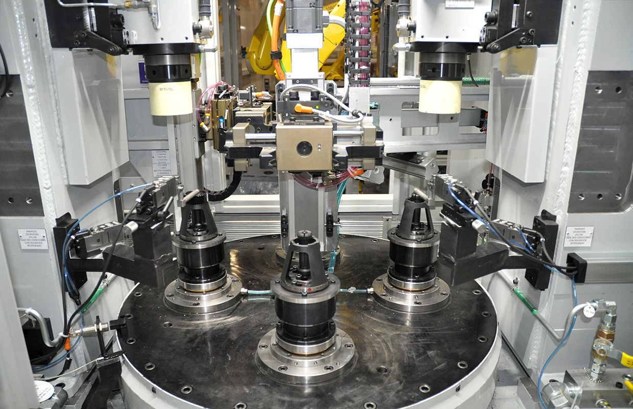

The SPV clamp bore face grinder the gear is clamped on the internal diameter of the bore and rotated in a direction opposite to that of the cup wheel at a high surface speed

A gear being finished in the Nagel SPV clamp bore grinder.
The part is clamped on the bore and located against the face to finsh the opposite face. Then, the part is then flipped 180 degrees to finish the other face while clamping on the same bore. In-process gauging permits tight control of thickness. The adjacent table illustrates the quality typically achieved by the combination of honing and clamp bore face grinding.
Nagel Precision Inc.’s SPV clamp bore gear grinder differs from conventional grinding operations, the accuracy of which depends on rigid fixturing as well as the accuracy of the grinding wheel’s position relative to the part.  By contrast, the SPV uses free-cutting cup wheels, and the tool self-dresses and conforms to the contours of the part. This automatically compensates for inaccuracies in the machine. During this operation, the gear is clamped on the internal diameter of the bore and rotated in a direction opposite to that of the cup wheel at a high surface speed. To prevent variations in flatness or axial run-out when finishing flat surfaces, the cup wheel tool substantially overlaps the surface of the part during machining. The machine can remove as little as a few microns of stock to few hundred microns very quickly.
The clamp bore grinding machine has a output of one part every 12 seconds, however single-spindle SPV machines are available for lower volumes and high chaneover scenarios.
