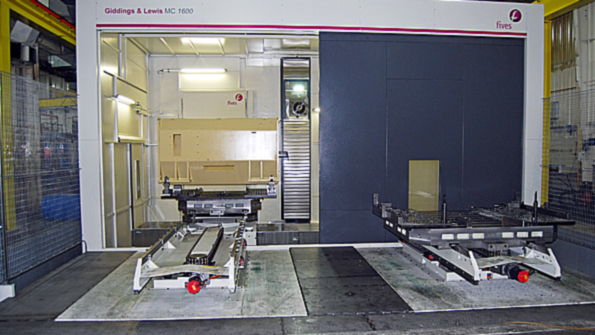

The Giddings amp Lewis MC 1600 horizontal boring mill from Fives is designed for multiaxis contour milling precision boring drilling and tapping At Milwaukee Machine Works it will produce various largedimension parts including windturbine gearbox housings and fluid end manifolds for oilandgas industry projects

Milwaukee Machine Works manufactures large-scale, critical-tolerance machined parts and assemblies, but it is increasing its part capacity and expanding its energy-sector business thanks to a dual-pallet Giddings & Lewis MC 1600 horizontal boring mill (HBM) from Fives. The rotary table HBM, designed for multi-axis contour milling, precision boring, drilling and tapping, was installed during the spring at the 80,000-sq.ft. plant in Wisconsin. Plans call for it to produce a variety of large-dimension parts, some as long as 10 ft (3 m) and weighing as much as 7,000 lbs. (3,175 kg), including wind turbine gearbox housings and fluid end-manifolds for the oil-and-gas industry.

The MC 1600’s dual 63.0 x 63.0 in. (1600 x 1600 mm) pallet shuttle system ensures high spindle utilization, and robust one-piece cast iron column base and bed provide a rigid machining platform to handle heavy cuts in hard materials. The column is X-braced to enhance structural integrity, resist deflection and minimize vibration.
Feed thrust in all three linear axes is 6,744 lbs (30,000 N). A built-in 360,000 position contouring rotary table with programmable mechanical clamp handles parts to 55,000 pounds (25,000 kg), allowing precision 4-axis machining on a variety of part geometries. Modular design allowed MMW to custom-configure the machine with a four-speed, 3,500-rpm/56-kW (76 hp) spindle, and 120-tool magazine.
The oil-lubrication in the air-through spindle feature automatically lubes the rotary coupling when air through the spindle is used, extending the machining periods.
The MC 1600 includes the Giddings & Lewis Adaptive Control and Spindle Load monitoring software packages to help reduce tool breakage and/or spindle damage in high-feed milling operations on tough material, such as the cast iron and 4340 steel, often machined at MMW. The Adaptive Control feature is easy to use, and adjusts the feed-rate between programmed minimum and maximum values. It compensates for changes in cutting conditions, such as depth of cut and material hardness, to maintain the desired cutting horsepower.
