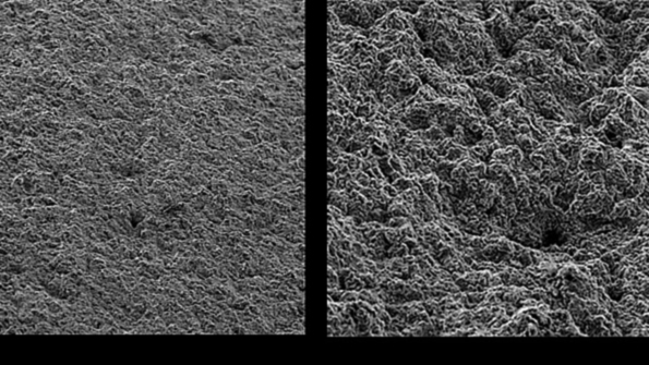

In their activated state the cylinder bore surfaces exhibit an optimal roughness for the thermal coating process

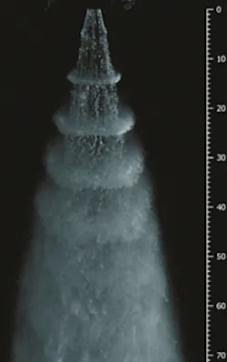

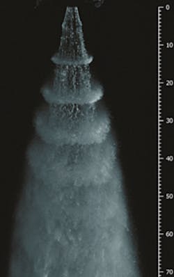

The EcoCBooster produces a pulsed water jet that delivers a much higher kinetic energy than standard ultra-high-pressure methods..

To optimize the adhesive pull strength of the coating, the aluminum cylinder bore surface is activated by roughening before the extremely thin (150 to 300 µm) and very hard metal layer is applied. Activation is typically done via high-pressure water jetting, mainly because it causes no wear and the roughened surface will not require cleaning afterwards.

Dürr Ecoclean has devised an integrated process that uses high-pressure water jetting to activate cylinder bore surfaces of engine blocks prior to thermal coating, using no more than 600 bar. The core technology of the new PulseBoreCenter is the “EcoCBooster,” which uses a pulsed water jet that boosts the kinetic energy by a factor of 5 to 10.

The results achieved with an EcoCBooster are equal to or better than those obtained by conventional processes using ultra-high pressures. This is confirmed by industrial applications to date: Adhesive pull strength levels have been found to exceed 60 MPa throughout, according to the developer, regardless of whether the metal coating is applied by atmospheric plasma spraying (APS) or arc wire spraying (AWS). The method allows even cast surfaces to be roughened to a degree that allows the molten metal particles to be firmly interlocked with surface.
