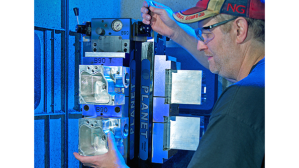

The hydraulic workholding system that Johnson’s company installed in 2001 was a six-vise, stacked ProHold model manufactured by Planet Products. Some job shops use it for welding and riveting as well as machining operations.

Shops using hydraulic vises often are applying them to production runs, where the consistency of clamping grip and ease and quickness of operation are most important. The operator simply sets the holding pressure, and the device holds each production workpiece the same way.
“Our hydraulic vises have a pre-set, c mechanism,” said Larry Johnson. “You just open or close the valve on it and the jaws open and close. Because we’ve got six vises on our system, we have one valve for controlling the front three vises, and another valve to control the back three vises. You just have to flip a valve and that opens and closes it. It’s really easy to operate.”

For example, the vises have a longer hydraulic stroke, which can facilitate quicker loading plus ability to clamp wide range of parts with same tooling. The long hydraulic stroke allows parts of several different sizes to be processed with the same top jaws, significantly reducing set ups time and effort.
“That definitely makes a difference in our application,” said Johnson. “Our workpieces  — the beams — weigh about 400 lbs., and the vises open up wide enough that you can load them quickly and easily.”
He added that automatically closing the vises simultaneously saves time and efforts. Each set of jaws moves independently and can clamp different-sized parts at the same time with uniform clamping pressure.
The hydraulic vises that I have will accommodate all three different sizes of the beams we machine,” Johnson said. “So, if you are running the same types of parts like we are, the hydraulic vises are an easy setup. It’s just a matter of changing the jaws on them and you’re ready to go again.”
