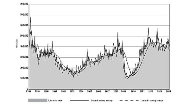

U.S. manufacturers ordered $354.40 million worth of new machine tools and related technology during February, a decline of 6.6% from January, and a similar 6.2% decline from February 2013. It was the second straight month of declining orders, and brings the 2014 year-to-date total for new orders to $733.82 million, which is down 0.6% from the two-month total for 2013.
The figures are included in the latest U.S. Manufacturing Technology Orders (USMTO) report, issued on a monthly basis by AMT - The Association for Manufacturing Technology. AMT tracks orders for metal cutting equipment separately from metal forming and fabricating equipment, with the combined figure representing the monthly total. The monthly results are based on the totals of actual data reported by companies participating in the USMTO program.
