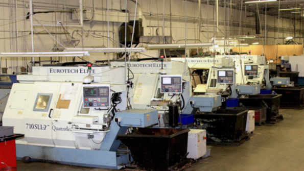

Ultimate Machining and Engineering in Plainfield Ill operates five Eurotech Elite multiaxis machines and finds their efficiency and easeofoperaton provide production flexibility even for jobs that call for high complexity machining strategies

Another source of confidence for Ultimate Machining and Engineering is the quality of its manufacturing systems, notably its choice of CNC machines built by Eurotech, a designer and builder of multi-axis mill/turn and Swiss turning machines.
Ultimate Machining purchased its first Eurotech machine in 2004. According to Kulczuga, the shop realized the Eurotech 420SLY mill/turn machine delivered multi-tasking capability that made it possible to reduce cycle times and cut set-up costs.

Ultimate Machining has achieved particular success with hydraulics industry orders that call for long-shaft machining, involving pinch turning and pinch milling while holding a part between both spindles. The Eurotech Elite CNCs are able to finish these demanding projects in a single operation.
Now, Ultimate Machining has installed five Eurotech Elite multi-axis machines — two 420SLLYs, two 710 SLLYs, and a B658SLY. It uses the dual 710s and 420s to make all of those spools for the Caterpillar order. The machines provide a degree of production flexibility that Kulczuga finds particularly advantageous. They typically take 3 to 12 minutes to complete a part (depending on the design), and even for jobs that call for more complexity are improved because the Eurotech’s offer cycle times half the time of comparable machines.  “And even more than 50%, sometimes,” Kulczuga said. “You can make a whole range of different parts on just one machine.”
One area of particular success with the Eurotech machines has been the hydraulics industry orders that Ultimate Machine takes on, namely “long shaft work”: this involves pinch turning and pinch milling while holding a part between both spindles.  The Eurotech Elite CNCs are able to finish such demanding projects in a single operation thanks to a proprietary attachment. With just one set-up, and later one inspection, the finished parts are unloaded by gantry arm in finished condition.
