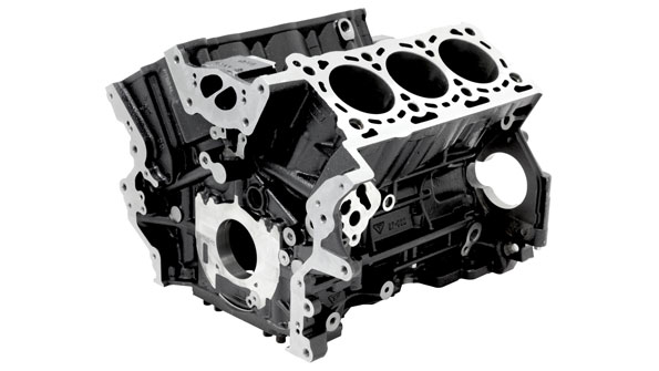

A 30liter V6 diesel engine built by VM Motori and cast in SinterCast CGI by Tupy is due to be introduced by Maserati as an option for its 2014 Ghibli Sports Sedan

Recent studies in CGI machining have focused on continuous cutting conditions that occur during high-speed cylinder boring.1,2  Boring of engine cylinders is one of the more critical operations in engine production, requiring high-quality surfaces to be produced at relatively high cutting speeds. It is at these elevated cutting speeds (250-700 m/min) where the machinability differences between CGI and conventional gray cast irons are most pronounced.
