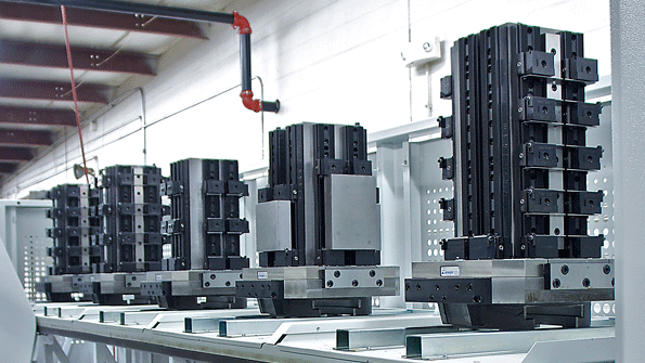

The challenge for Alvin Goellner and his team at AME was to design a series of fixtures flexible enough to hold 56 different block sizes, to offer quick changeover, and to establish an ability to run different parts on each side or run multiple pallet loads of the same part in high production, when needed.
“It was a real one-size-really-can-fit-all situation,” Goellner noted, smiling. “We knew the HMC with pallet changer was very costly to run, so keeping downtime to a minimum was essential.”
The solution came in the form of 10 Triag custom-modular tombstone-style fixtures from AME. Triag is a Swiss workholding component supplier, and AME is its exclusive North American distributor.
Illustrations show the various arrangements of workpieces possible with the custom Triag tombstone-type workholding devices supplied to TRD Manufacturing by Advanced Machine
“The fixturing in our existing machining cell was fixed, based on block size,” Jensen noted. “AME fixtures use a vise system that quickly adjusts to any size with repeatability, a really key factor in the equation, as it allows all our work shifts to be pre-taught the process.  We normally have the fixtures set for specific part sizes but this AME solution now allows us to run any size part on any pallet very quickly for high-volume jobs.”
He observed there was a very short start-up time in the TRD shop, as the flexibility of the tombstone design and the fixturing mechanisms were relatively easy to learn for the operators.
“We met with Alvin Goellner and brainstormed the improvements needed on our current fixturing system,” Jensen continued. “AME laid out a concept and provided drawings for each fixture, which we then reviewed and approved, based on our current production schedules and anticipated workloads, going forward.  All the fixtures ordered arrived on-time or ahead of schedule, a very refreshing experience.”
Goellner was the lead man for AME on the project, bringing his 20+ years of fixture design and build experience to the task.  Because all aspects of this project’s customized manufacturing, assembly and test of the Triag tombstone fixures were done in-house at AME, there was little delay in the processing of the project and all design changes were quickly accommodated, according to Jensen.
“The overall experience was excellent and the results have been outstanding for TRD.  The project went well and all our expectations were met,” Reinhardt commented. He estimated the improvement percentage in production on the Enshu HMC to be over 40%, after several months in operation.
