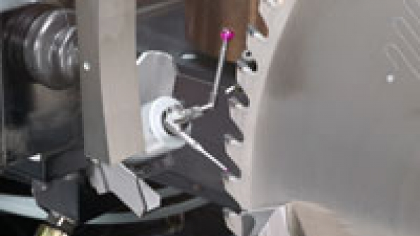

The Vollmer erosion machining center measures the dimensions for teeth of a PCD blade.

Because of the high-wear rate of diamond cutting tools when cutting PCD blades, erosion machining is the most cost-effective finishing process for the blades.

Due to the abrasive nature of the diamond or PCD portion of the tool, specialized equipment is required to shape or machine the diamond cutting edge. Traditional grinding can be used in the fabrication of certain diamond tools; however, the diamond grinding wheel wears quickly when tasked with grinding the PCD. As a result of this excess wear, erosion machines are the most cost-effective choice today.
Vollmer is the technology leader in this machine tool niche, with several types of equipment that use various rotary and wire erosion methods. “They can manufacture or sharpen just about any PCD tool that exists,” according to Ron Wiesner. “We are constantly looking for new industries where we can introduce PCD tooling, and the Vollmer equipment is so versatile that there is no limit to the markets we can enter.”
The erosion process takes advantage of the conductivity of the PCD layer to “arc” or erode the diamond, in order to obtain the desired geometry for the finished tool. In 2008, RKO invested over $1 million in new capital equipment including erosion machines. “We first purchased a Vollmer QM ECO which can sharpen profile as well as straight tools,” Wiesner now recalls. “Six months later we purchased Vollmer’s QR and QF models, with robotic loading capability. This cell gives us the ability to erode the outside diameter and the side geometry of PCD saws with one set-up.”
