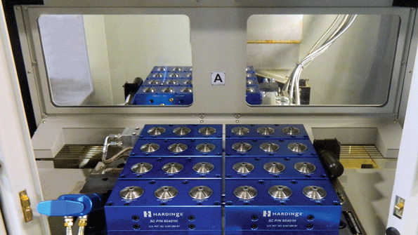

Eight TriGrip 5C collet blocks shown with the hydraulic quickdisconnect feature

Hardinge detailed recently that collet blocks can be used horizontally or vertically on mill tables, jig grinders, flat or angled fixture plates, tombstones, or rotary trunnions. They can be grouped effectively, hydraulically or pneumatically, for high-production multi-part machining. Part gripping sizes range from 0.008 in. (1C collet) up to 6 in. (step chuck) in diameter. Hex, square and custom-shaped collets are available to hold a variety of shapes.

Most shops prefer to use pneumatic-operated collet block systems, because the shop air is available and easy to connect, eliminating the need for plumbing accessories. If shop air is not available a small compressor will work as well. Filtered air is always recommended. A simple pneumatic arrangement will consist of a sub plate to mount the collet blocks on and a control valve to clamp and unclamp the part. Use one valve to clamp and unclamp all parts simultaneously or configure multiple valves to control each block or row of blocks independently.
Some Hardinge collet block models will plumb together with connector bushings for internal plumbing. Collet block models that don't use connector bushings will have to be plumbed externally.
Hydraulically operated collet block systems provide a higher clamping force. A hydraulic collet block arrangement will require a hydraulic source. If a machine has no hydraulic source, Hardinge offers an inexpensive air-over-hydraulic pump and accessories for a compact setup. Uses a 2-position, 4-way control valve to clamp and unclamp all parts simultaneously, or to configure multiple valves to control each block or row of blocks independently. The control valve would mount on the fixture along with the collet blocks and connect to the pump outside of your machine.
Quick-Disconnect Systems
A quick-disconnect system is optional. A quick-disconnect handle with standard manifold sets up quickly, according to Hardinge, but it will not maintain the clamp position when removed from the manifold.
To maintain the clamped position when removing the disconnect handle, use the manifold with a built-in check valve. This option is ideal for preloading pallets. A 3-position, 4-way control valve is required when using the manifold with check valve. An accumulator is recommended and the control valve would be mounted outside of the machine. The accumulator is available in a vertical or horizontal mount and would mount on the fixture with the collet blocks.
The advantage of machining multiple parts in one setup is huge. The collet block offers advantages over vises and other fixtures. A collet automatically centers the workpiece for reduced setup time.
Centers remain fixed when the fixture is removed from the machine table. A collet provides equal gripping pressure around the circumference of the part unlike a standard vise or a 3-point contact jaw chuck. Thin-wall parts or delicate materials may crush or distort in a standard vise or jaw chuck. Sure-Grip expanding collet systems can be used in select collet blocks for internal gripping of the part.
