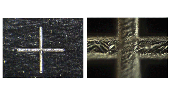

Figure 5 – Precision and control using a fiber-laser marker. Source: Miyachi Unitek
The finesse and machining control that is possible when using the single-mode fiber laser is highlighted in Figure 5. There, the fiber-laser marker was used to machine a 25-micron thick metal foil to a 13-micron depth. The application was to provide a preferential failure point in a component. The channel width was 75 microns and the depth variation over the entire area was ±1 micron. (This equates to taking material that is one-fourth of the width of a human hair and leaving only about one-tenth of a human hair after micromachining.)
