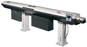

The first of the new bar feeders to be introduced at EMO will be the Express 332 S2, and update to the Express 332 series for handling long bar stocks, launched in 2001. “It was now time not only to refresh the product, but to redesign it from scratch,” according to Carlos Muniz, LNS global product manager for bar feeders. The Express 332 S2 combines the best elements of the Sprint and Express series and improves the design’s rigidity, flexibility and user friendliness.
In the new Express series, LNS adapted insights gained from its Sprint family of bar feeders and used the mechanical-beam concept to increase stability, optimize dynamic behavior, and provide “perfect” guiding. A fast diameter changeover makes the bar feeder very flexible.
“We redesigned and optimized the bar feeder, but we also kept its philosophy and all the features that made it so successful,” Muniz said. The Express 332 S2 is equipped with a color touch screen, making it easy to control the shape, diameter, and feed length, and to troubleshoot process delays. All elements are compatible with the Express 332. The 32-mm segment especially targets machine shops serving medical, electro-mechanical, hydraulic, aviation, and automotive industries, LNS indicated, and like all its bar feeders the Express 332 is fully CE compliant. “We cooperated with external consultants to perform risk analyses for all machines and optimizing them,” Muniz reported.
