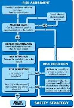

Typical Risk Assessment/Risk Reduction process.

Assessing risk
The process of developing a safety device to reduce or eliminate a hazard involves analyzing each element of machine operation. Hazards are a safety concern in areas where operators, maintenance personnel, or others must stand or pass by a machine. A machine may have one or more hazard points or areas of hazard. These include pinch points, web or roll nips, punches, shears, hot surfaces, blades, flammable vapors, and protrusions. Each hazard should be reviewed based on the function of the personnel approaching or using the machine at each location.
Generally, a risk hazard analysis starts with a list that matches each hazard to the task performed at a location. It is possible to have multiple hazards for each task and location, so a risk assessment for each hazard/location pair must be performed.
The first step in a risk analysis is to assign a risk value to each paired hazard/location as a function of three considerations: severity of a potential injury, frequency of exposure, and the probability of an accident. Each consideration is then categorized according to severity of a resulting injury, frequency of exposure, and probability of occurrence. A numerical value is then assigned to each of these categories. The following example describes the risk-analysis process.
The degree or severity of an injury can be described as minor, serious, major, and fatal. A minor injury would be a bruise, cut, or abrasion. A serious injury would result in the loss of consciousness. Major injuries are typically considered irreversible and permanent and include burns, broken bones, loss of sight or a limb, or some other permanent bodily damage. A fatal injury is the most serious situation.
A numerical value is assigned to each category: 1 for a minor injury, 3 for a serious injury, 6 for a major injury, and 10 for a fatality.
Frequency of exposure to a hazard can be described as frequent (several times a day or more), occasional (daily), and seldom (once a week or less), with assigned values of 4, 2, and 1, respectively.
Probability of occurrence of an accident can be described as unlikely, possible, probable, and certain with respective values assigned of 1, 2, 4 and 6.
In this example, the maximum total risk for all three categories is 20 and corresponds to the most serious condition. If a risk was estimated to have a cumulative total of 13, it might be considered a medium risk.
Additional tasks associated with a particular hazard are similarly analyzed and assigned total-risk numbers. The total-risk summation of all tasks considered for this particular hazard is used as an initial-risk value in an iterative risk-reduction process, which is then run for each remaining category. This lets users develop a structure to identify hazards with relative weighting and experiment with various remedies and machine guarding equipment.
