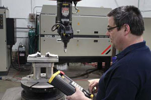

Steve Leitner, president of Rentiel Precision Laser Cutting LLC in Federal Way, Wash., “teaches” a part program prior to processing on the Laserdyne 890 BeamDirector. Leitner was involved in the purchase decisions for many Laserdyne systems before buying two to start his own contract fabricating business.

As he grew more experienced with multi-axis laser processing, Leitner was growing aware of the potential for a fabricating job shop to specialize in that service. “When a used Laserdyne 780 BeamDirector became available on the open market, I bought it,” he explained. “It took some work to re-commission the machine but I fitted it with a JK701 laser, a rotary table and shuttle table. I started operating it at home in my garage. I ran jobs off hours for my employer for a few years, and when a previously owned Laserdyne 890 became available I decided to buy it and to work full time in my own business.”
The specialty at Rentiel Precision Laser Cutting is laser processing three-dimensional aerospace parts, like scuff plates, de-icing tubes, exhaust liners, and other types of jet engine transition components. Rework on high-value aerospace parts is another aspect of the business that’s growing. Leitner said the Laserdyne systems’ flexibility and accuracy allow his shop to excel at processing new and refurbished parts. “Jobs we do that previously were milled required multiple setups and multiple tools,” he pointed out.
“Cutting and drilling the parts in one setup using a single tool is much faster, and ensures that the part conforms to the required tight tolerances,” he detailed. “With our laser systems, there is virtually no cutting pressure so the tooling is very simple and robust, at a fraction of the cost of mill tooling.”

“Using the five-axis capabilities of Laserdyne, we are able to laser-process parts completely in a fraction of the time it would take to complete them by machining or hand work,” reports Leitner. “The repeatability of the systems is outstanding. We produce better parts because we can scan and measure the sheet metal part before processing, and offset the program to the part. The only variable we constantly see is in the part contours as we receive them. This is typical in the sheet metal world. A part may have a contour allowance of 0.030-in. and we need to hold a dimension with 0.005-in. This is easy to accomplish with the Laserdyne’s ability to scan the part automatically and reposition the program back to the datum features.”
