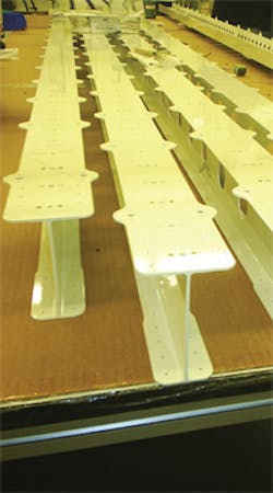

Aluminum extruded aircraft floor beams, at Triumph Structures-Kansas City.

Extensive aluminum extrusion machining capabilities have set Triumph Structures-Kansas City, apart from the competition. About three-quarters of the aerospace shop’s work involves parts made from such extrusions.
It currently produces more than 1,500 separate part numbers out of its extrusion operations, and some individual part numbers can require running anywhere from 1 piece to 8,000 pieces per year.

Aluminum-extrusion machining operations at Triumph Structures include drill and trim and gage reducing. Drill and trim is milling the net shape of the extrusion, such as the three sides of a T-shaped extrusion, and putting in some holes. Gage reducing involves machining the cross section of an extrusion. Some extrusions are simply cut to length and have a few holes drilled in them.
Eleven Modig Profile Line machines do most of the extrusion machining at Triumph Structures, with the cell capable of producing over 40,000 pieces per month. The machines, for the most part, are identically configured.
They each have right and left side chucks that allow for machining all four sides of a part in one clamping, which reduces setup time. Raw extruded material slides into the machines much like bar fed stock feeds into a turning machine, and the two chucks secure the material for machining 36-in. part sections at a time. About 99 percent of the time, components come off the Modigs complete, not needing any secondary machining.
