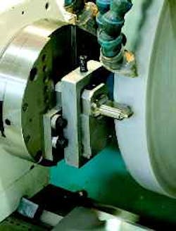

Stema Punch & Die rough and finish grinds punches made from extremely hard material, such as M2 tool steel, on its Studer S32cnc punch grinder.
Some of the punches Stema Punch & Die produces require O.D. tolerances of ±0.0003 in., and its S32cnc grinder holds tolerances to ±0.0001 in. for profiles up to 3 in.

For Stema Punch & Die in Cambridge, Ont., the latest in punch grinding is a Studer S32cnc from United Grinding Technologies, Miamisburg, Ohio. This punch-grinding machine, which joins Stema's two other CNC punch grinders, not only meets production needs but also provides Stema with a degree of flexibility for handling hard materials such as M2 tool steel.
Mostly, the Studer roughs and finishes punch blanks ranging in size from 0.125 to 3 in. in diameter and 2 to 6 in. in length. "In some cases," says Stefan Lorbach, founder of Stema Punch & Die, "we have to do secondary operations, but these usually involve EDMing additional profiles, threads, or keyholes. Still, about 80% to 90% of our punches are roughed, finished, and ready to go when they come off the Studer."
In addition to flexibility, Stema relies on the Studer's ability to hit and hold close tolerances. Lorbach reports that most of the punches require an O.D. tolerance of ±0.0005 in. However, some must be held within ±0.0003 in.
"The Studer easily handles a ±0.0001-in. tolerance," points out Lorbach, "and a 1.00-in. ground profile, which is basically standard. But it also tackles 2.500 to 3.000-in. profiles for custom punches, giving us an additional competitive advantage."
Programming the Studer also provides flexibility and increased throughput for Stema. The machine control stores process parameters for many routine jobs and makes changeover from job to job as easy as calling up a part number on its Fanuc 16i touchscreen, letting the machine adjust itself. For its tricky parts or new, complex ones, Stema uses the machine's built-in routines for specific needs and then stores them for the next time the part comes along.
