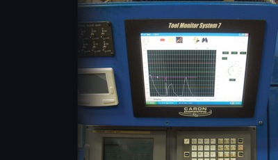

How Adaptive Controls Work
Adaptive controls are an extension available on some tool-monitoring systems. A typical adaptive control system will measure the horsepower load on a spindle motor either by tapping into a machining center's spindle-load sensor data or by getting data from an added transducer. The user programs an ideal horsepower for a particular cut, and the system takes control of the feedrate override to maintain that constant horsepower. Until recently, adaptive control systems were cumbersome and difficult to program. Now, these systems come with graphic displays that show the feedrate that is being applied and the horsepower being used. The operator can increase or decrease the amount of feedrate override with the push of a button. Additionally, the machine's controller can be programmed to turn the adaptive control function on and off at any point, and the function can also be assigned to each tool in the machine.
A tool-monitoring system allows the machine operator to set load thresholds and other parameters to trigger an alarm and to stop the machine if the thresholds are exceeded. However, an adaptive control system adjusts the feedrate to prevent tools from reaching those thresholds. While there are a number of companies making tool-monitoring controls, only a handful also provide the adaptive control option.

"Adaptive control is especially useful when machining forgings and castings," said Rob Caron, president of Caron Engineering. "We've had customers find chunks of harder metals in their castings — steel nuts and bolts that had fallen into the molten cast iron. When a drill or milling insert hits something like that, it often breaks, but the adaptive control system immediately senses the difference in hardness and just slows the feed rate down until the bit is through that spot. Even if there are no unexpected chunks in the metal, the hardness of castings can easily vary as much as 300 percent, and the adaptive control system will adjust feedrates to handle those variations. We sell a lot of our adaptive control systems to aerospace — General Electric and Pratt & Whitney. They machine metals so hard that tools can get dull on a single cut. When that happens, the tool might break in the cut causing scrap or rework, but with adaptive control, the feedrate slows down and allows the dulled tool to finish the cut."
"There are several companies that make tool-monitoring systems, but they don't get into adaptive control," said Caron. "Everyone that has it loves our system, and they buy more of them and put them on more machines. But why more people are not using them is beyond me. There is some work being done in university labs, but they are trying to take it to an extravagant level where they want to incorporate acoustics and modify the spindle speed at the same time as the feedrate. By trying to do both, you compound the complexity, and the control may not be responsive enough to override the feed rate quickly enough. Of all adaptive cutting, 80 percent to 90 percent can be done simply by overriding the feedrate based on horsepower."
