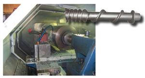

A Romi M27 lathe machines large feedscrews for meatgrinding machines at Rome. Rome Ltd., a Sheldon, Iowa, meat grinder machine manufacturer, scrapped its manual engine lathes and decided to turn ...
Rome Ltd., a Sheldon, Iowa, meat grinder machine manufacturer, scrapped its manual engine lathes and decided to turn large feedscrews and other components that power its equipment on more robust CNC lathes. As a result, the company has saved money and improved production 4:1.

For feedscrews that can range in length from 24 in. to 70 in. with external diameters from 6 in. to 20 in. made from mild and stainless steel versions, Rome now turns O.D.s and I.D.s, threads and establishes overall lengths using two Romi Machine Tools Ltd. lathes – an M27 and M33.
The robust Romi machines weigh in at 14,000 lb for the M27 and 33,000 lb for the M33. Both lathes have 80-in. bed lengths, and Rome splits its turning work between the two machines. The M27 handles the noninterrupted turning on new feedscrews, while the M33 machines larger feedscrews and tackles heavy interrupted cutting on reworked feedscrews.

“We grew tired of rebuilding our engine lathes every two years. Completely tearing them down, regrinding ways, and refitting everything just became too expensive. We needed lathes that could stand up to our type of machining. The weight and size of the Romi lathes make easy work of the heavy interrupted cutting on our feedscrews. And feedscrew machining time has dropped from 4 hours to 1 hour,” Jongerius said.
He estimates the shop spent between $8,000.00 and $10,000.00 per year on maintaining the old manual lathes. That savings, along with the four-fold increase in production, made upgrading to the Romi lathes an easy decision.
When customer feedscrews come back to Rome for refurbishment, the flights are welded where pieces have broken off during use. These welds are what creates the heavy interrupted cutting conditions and what put such a severe strain on Rome’s former engine lathes.
