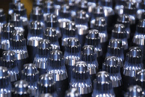

A sea of completed pinion driveshafts. Note the quality of the tapered splines.

A close-up view of the hobbed pinion spline. It is a short spline (3/4 in.) that rises up to a taper, at which point the pinion gear is mounted.

“The spline I’m hobbing is only about 3/4 in. long,” Lefeber continued, “but we’re hobbing into a taper. The spline follows a diameter for 0.400,” but then it goes into a taper another 0.350.” This is the shaft that transfers power from the crankshaft to the gear case. The taper is the point where the pinion gear is mounted. The pinion gear drives the gear case for forward and reverse gears. This pinion spline needs to have a low run-out, and it’s absolutely critical to the driving application.
