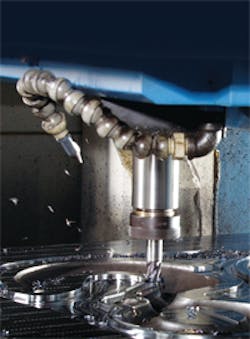

A Hi Pos Deka tool in process and making chips.

Actually, Crosby-Lebus’s tenfold improvement in deck-surface reconditioning arose from a problem the company didn’t know it had. The shop was satisfied with the 15-ipm feedrates it was getting with a conventional zero-rake indexable finishing face mill, even though Schooley had given it a Hi-PosDeka face mill, new at the time, for evaluation in March, 2008.
Crosby-Lebus began a general evaluation to see what the new cutter could do, but never pushed the feed or targeted an application. Then, six weeks later at a seminar in Rockford, CNC machinist Sidney Maxwell saw the same cutter feeding at 150 ipm on the same type of hardened stock that he was running in Longview.
The day they returned from the seminar, Maxwell and Schooley set up a trial on a live repair job and got the same results — a tenfold gain on an operation they thought was running fine before.
That was with the same cutter and pitch as before: 2 in. diameter, five inserts.
The difference was in the cutting-edge geometry.

Maxwell and Schooley tweaked the operation to optimize throughput and edge wear. The new standard settings are 150 ipm, 850 rpm, 0.035 in. depth of cut, compared with the previous parameters of 15 ipm, 650 rpm and 0.100 in. depth of cut.
“We traded some depth of cut for an order-of-magnitude gain in feed: I’ll take that any day,” Walston said.
For example: Skin milling a typical mid-size (20 in. by 20 in.) die set used to take 90 minutes. Now it’s done in 10 minutes.

“Although the cutters were the same size and pitch, the Hi-PosDeka cutter has a positive rake, not zero as before,” Schooley said.
“Moreover, a large wiper flat behind the cutting edge ‘burnishes’ the newly machined area to maintain good surface finish despite the higher feed. And, the inserts are thicker than the ones used before, and therefore stronger,” he added.
The inserts also provide 10 indexable cutting edges, which contributes to their “Deka” name, versus four cutting edges on previous inserts. That also helps to reduce insert inventory requirements.
