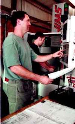

CNC programmer Jeff Mauney reviews part specifications in preparing to program Allied Manufacturing Technologies' Haas VF-1 for a second operation on the workpiece.
