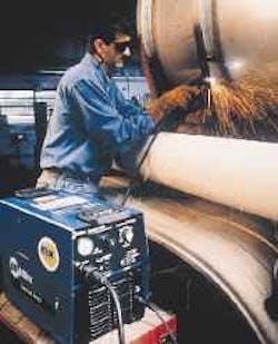

Operators avoid the time-consuming task of manually adjusting a plasma cutter to match available voltage using Miller-developed Auto-Line technology. Found on the Spectrum 2050, Auto-Line automatically senses the available voltage and directs the connection to any primary power level from 208 to 575 VAC on a single or three-phase circuit operating at 50 or 60 Hz.

Another technological advancement is Miller's Auto-Line. Found on its Spectrum 2050, it lets the plasma cutter operate at any location, in any country. The plasma cutter automatically senses and then connects to any primary power level from 208 to 575 VAC on a single or three-phase circuit operating at 60 Hz. Auto-Line even works on the predominately European frequency of 50 Hz. An added benefit of the technology is its ability to handle fluctuations in the utility power supply, ensuring consistent cutting output.
