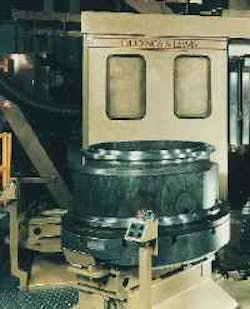

Solar Turbines Inc. chose the OEM as a single-source supplier for remanfacturing this and another VTC. Giddings & Lewis, the OEM, transformed each machine into an independent, automated machining cell.

When Solar Turbines Inc was in the process of considering whether to buy new machines or remanufacture its two existing vertical turning centers (VTCs), it learned that using the machine carcasses would save about $200,000/machine as compared to the cost of purchasing new machines. So Solar, a subsidiary of Caterpillar Inc., chose the remanufacturing method of machine modernization.
In the process, each original standalone Giddings & Lewis VTC was converted into an independent machining cell consisting of a rotary setup stand and three park stands. With these special stands, Solar can now set up and indicate parts in before shuttling them into each turning center.
Both machines, first installed in 1983, were producing a wide range of turbine parts in nodular iron and cast steel, ranging from 20 in. in diameter and 40 in. high to 48 in. in diameter and 10 in. high. But Solar wanted to upgrade its VTCs in order to improve cost efficiencies, quality, and throughput.
Original machines were 48-in., plain ram-type turning centers with 12-position tool carousels, moveable rails, and G&L 800 controls. Solar Turbines shipped only the base, column, and crossrail of each VTC to G&L.
As a result of remanufacturing, both machines now sport a 54-in.-diameter chuck, pallet shuttle system, additional height under the rail, more ram travel, and a 45-matrix batch toolchanger. G&L's NumeriPath 8000 CNC with a NumeriStation option (a PC integrated into the CNC operator station) runs the machines, while a CM90 cell controller handles the pallet shuttles.
Other new features include a programmable rail, automatic rail leveling, automatic part and tool probing, and an automatic tool-condition sensor system. The lubrication and mist collection systems, along with the coolant chiller, are also all new.
