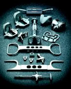

MEDICAL DEVICE MANUFACTURERS FACE TOUGH challenges. Their customers are demanding ever smaller, more complex parts produced with extraordinary accuracies from difficult to machine materials, such as titanium. On top of this, they must operate under the close scrutiny of regulatory agencies that require extensive and costly compliance documentation.
Orthopedic devices are designed to conform to the complex shape of bones and joints, so the machining of these parts is also complex. Devices machined from bar stock require a lot of material to be removed, resulting in an expensive process because of the low machinability rating of many of the materials involved. As a result, some parts are cast to near net shape, and that often requires fixturing that is complex and expensive. Another issue that adds to the complexity of machining is the tight tolerances required—0.002 in., or less—for most devices.
These pressures have given rise to new technologies to help shops that manufacture medical parts to cope and compete. Agile 12-axis turning machines tools, new insert grades and innovative thread-whirling machines are capable of producing complex parts to extreme tolerances, while innovations in EDM result in the production of high-quality parts at faster rates by eliminating the problems that were inherent in earlier technology.
