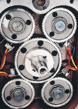

The new plant's five-spindle milling heads, made by Zagar Inc. of Cleveland, run at high rpm to reduce skin machining time. They also include monitoring devices for an aggressive Boeing preventative-maintenance program, quick-disconnects for simplified rebuilding operations, and innovative, programmable lubrication systems.
In Zagar's five-spindle setup, the main center spindle drives the others and connects to the machine tool's spindle via CAT #50 taper milling machine mount. The four corner, or orbital, spindles each have #63 HSK sockets for quick-change, high-velocity tooling that handles a cutting load up to a 25 hp. Rotating at 7,200 rpm, the center spindle (HSK 100) cranks the four orbital spindles up to 10,000 rpm.

The Boeing Huntington Beach plant machines different rocket skins using multispindle gear boxes designed in the mid-seventies. Their speed is limited to 6,000 rpm, so Boeing asked Zagar to speed up the new ones to better handle increased production. Increasing spindle speed, says Randy Roberts, vice president of Zagar, involved refining gears, bearings, the gearbox casting, and bearing lubrication.
In a combined effort, Zagar and Cincinnati Machine incorporated ceramic hybrid bearings and established special clearance calculations to produce bearing packs that could deal with the increased speed. Besides its engineering expertise, Cincinnati also supplied machine time at its facility for testing Zagar's prototype heads.
"Basically," says Roberts, "we reset parameters for assembly, preload, and clearance of the heads' spindle cartridge packs." The four outside spindle heads all have individual, rigid bearing packs. The center spindle has only a bearing pack at the bottom of the head (near the base). Its upper pack is actually the drive spindle of the machine. What's also critical, adds Roberts, is that the bottom of the four spindle noses must be on a common plain within three-tenths and perpendicular within a thousandth of an inch.
Faster spindles also meant that Zagar had to develop a special head casting with chambers for flow-through coolant. "It helped that we knew what type of machines the heads would reside on," says Roberts. With this knowledge, Zagar designed its heads to tap into the Cincinnati machines' on-board chillers. These circulate a tempera-ture-controlled water/ glycol solution though the milling head and the machine's spindle drive motor.

Zagar incorporated thermo-coupled sensors that record heat spikes in bearings. The gantry machine's controls monitor these sensors and, in the event of excess heat, will shut down the system, a safeguard developed by Cincinnati.
Four locking bolts secure each head in place and allow for quick disconnection and removal of the upper housings. Boeing stocks only a small number of spare ceramic bearings and spindle sleeves for quick repairs.
