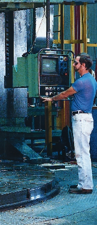

It's a Mesta vertical boring machine remanufactured by Dorries of Germany, and Voith uses it to rebuild hydraulic turbines for the hydroelectric industry. The company restores these turbines to like-new condition and increases their power output to generate more kilowatt hours.
According to manufacturing manager Steven Schmidt, the now CNC machine plays a critical role in the manufacturing of turbine components. Voith machinists re-bore the headcovers and bottom rings so that wicket gates and bearings on a vertical shaft accurately line up. These components vary in size depending on the unit. Smaller turbine components weigh 2,000 or 3,000 lb, while the ones run on the big Dorries can weigh more than 300 ton, measure 10-ft tall with 36-ft diameters.
The machine is built to handle the big stuff, having a 38-ft, 219-ton table that rotates at a top speed of 12 rpm. Two rams, one of which has a live spindle, feed out 10 ft, and the machine's adjustable columns provide up to 19 ft under the tool.
