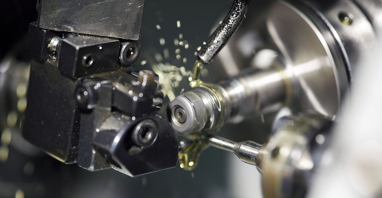

Lubricant in close-up of a turning operation.

Cutting fluid is a type of coolant and lubricant used in machining operations. It cools the workpiece to prevent part warping and coarse surface finish while providing lubricant to reduce friction between the chip and cutting edge.
Machining generates a lot of heat due to friction between the toolhead and the workpiece, making the cooling and lubricating properties of cutting fluid ideal for relieving this stress. Fluid also can flush chips from the cutting edge, which otherwise may build up and interfere with the machining process.
In some instances it's possible to machine without cutting fluid, such as when creating small parts or working with brass or cast iron. However, using cutting fluid increases part quality and prolongs the service life of cutting tools and machinery, making fluids indispensable in almost any machining operation.
