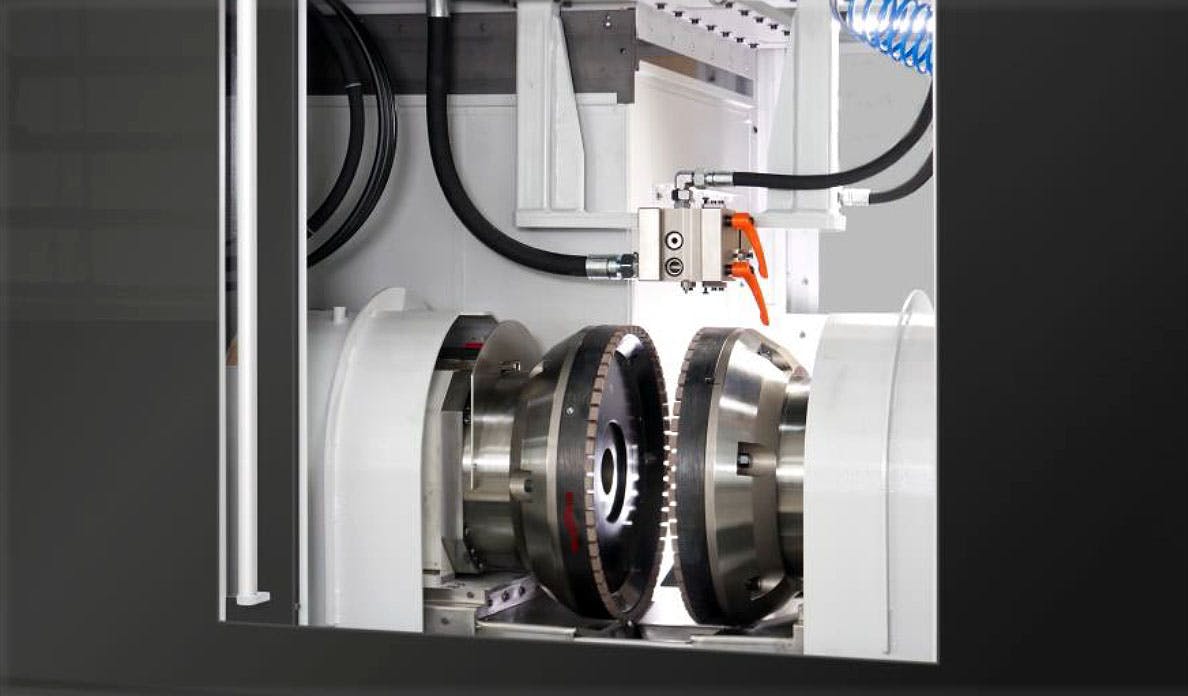

Double-sided grinding
Almost 100 million brake discs are produced in Europe every year; around half of these are for vehicle manufacturers and the rest for aftermarket parts. Experts assume that the vehicle industry will need to invest billions to produce brake disks that will reduce fine-dust emission levels. "Until recently, some brake discs were so cheap that they were sold by the metric ton," Supfina’s Wöhrle noted. "Expensive raw materials and processes have now been added to the mix, and with them the challenge of developing a product suitable for the mass market."
Double-sided grinding is favored by machine manufacturers because, according to Wöhrle, it guarantees simultaneous machining of both friction ring surfaces, high throughput rates, and short cycle times.
Supfina recently unveiled the Planet BD double-side grinding machine specifically for high-volume grinding of brake discs, and already it has been adopted by a number of well-known customers.
