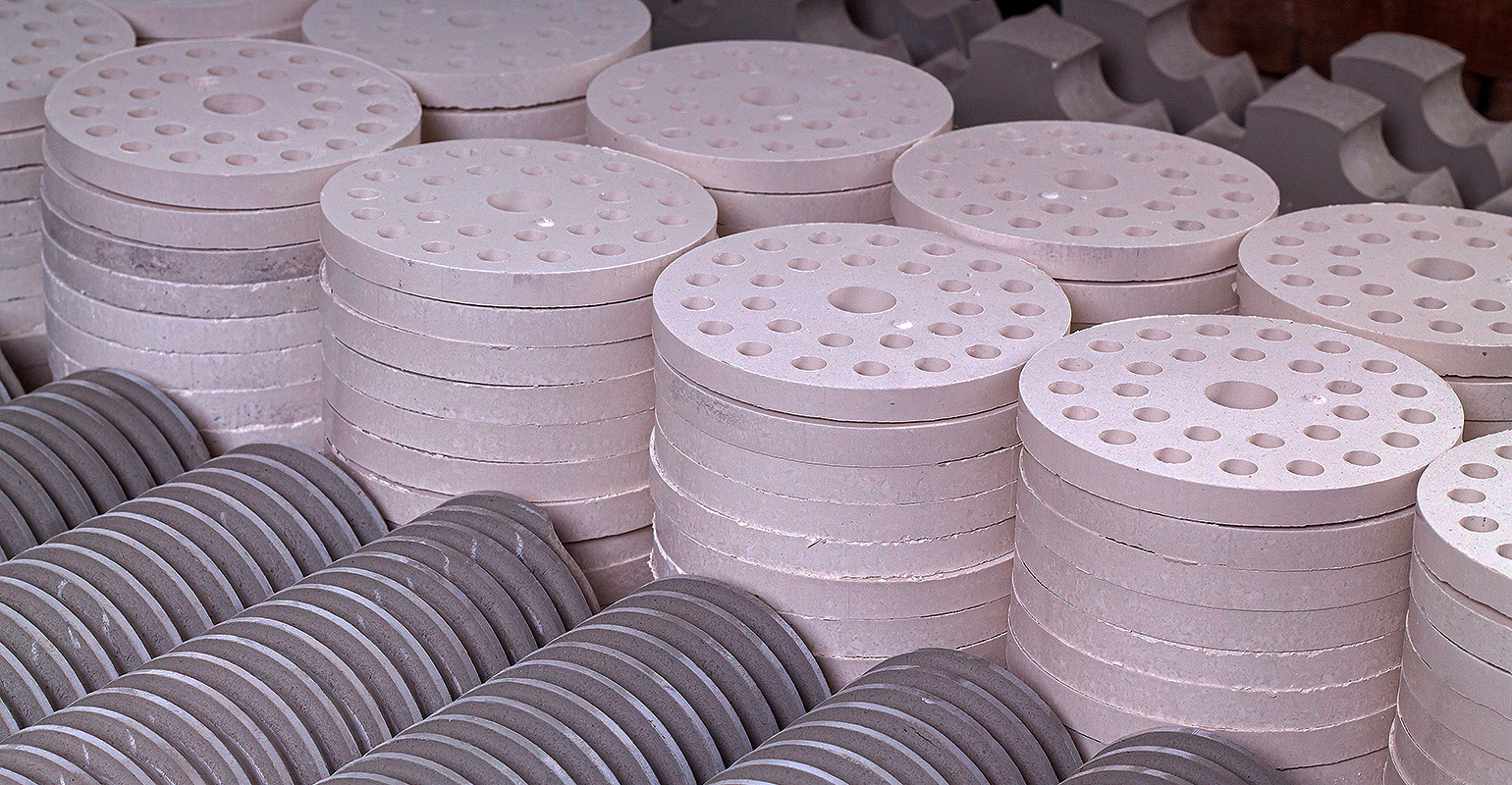

Ceramics require specialized precision grinding to achieve required tolerances due to the material’s exceptionally hard, dense, and brittle characteristics.

Ceramic materials are used to manufacture a range of industrial, commercial, and consumer products. With hard ceramics, grinding is essential process to achieve close tolerances. Some materials’ exceptionally hard, dense, and brittle characteristics mean that ceramics require specialized precision grinding to achieve required tolerances.
However, due to the brittleness of ceramics, particular care must be taken to avoid surface damage, edge chipping, and pitting, as well as microcracks and fissures that can render a workpiece useless.
