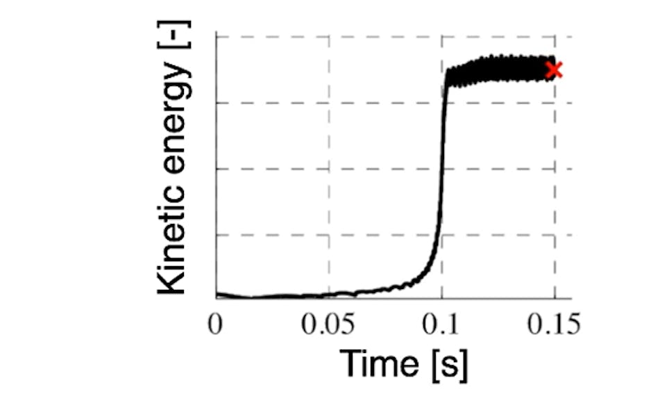

The cage instability phenomenon involves a sudden and significant increase in the kinetic energy of the cage, which results in an abrupt and pronounced disturbance. The energy involved in this phenomenon is exceptionally high, causing a “hula hoop” movement of the cage, also called cage whirl. Remarkably, the speed of this whirl can reach up to one-hundred times the rolling speed of the bearing.
What sets this phenomenon apart is its distinct ‘On/Off’ characteristic, differentiating it from the gradual noise generated by normal bearing degradation. In the same way that this behavior was difficult to predict and characterize for space applications, it was also difficult to apprehend in the context of machine tools. Once again, until now.
