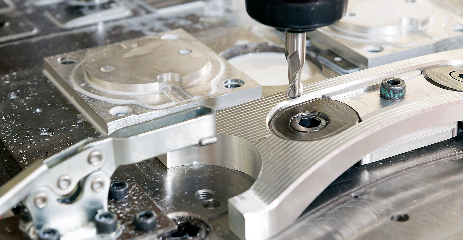

CNC milling machine with an automotive part.

Taking advantage of high-speed machining
High-speed machining (HSM) is often defined as a milling technique that utilizes spindle speeds of 20,000 rpm or greater, and relatively small radial depths of cut (less than 25 percent of the cutter diameter.)
As the radial depth-of-cut decreases, the effective chip load declines, Dominski said. That means “chip thinning compensation must be applied so that the tool’s recommended chip load is being cut by each tooth,” he continued. “If this does not occur, you may actually rub the part, resulting in surface-finish issues.”
And those are only parts of the equation. Machining at these speeds requires cutters designed for extreme heat and efficient chip evacuation, as well as a machine tool with a motion-control system able to achieve commensurately higher feed rates, often in the face of rapidly changing toolpaths.
The technique is mostly utilized in the die and mold industry, “where materials are hard (35-65 HRC) and larger cuts are not possible,” Dominski said. “The machine tools used here are generally the most capable, as they have high accuracy and look-ahead capabilities, very responsive controls and servo systems, and are quite capable of the quick, precise movements needed in these applications.”
