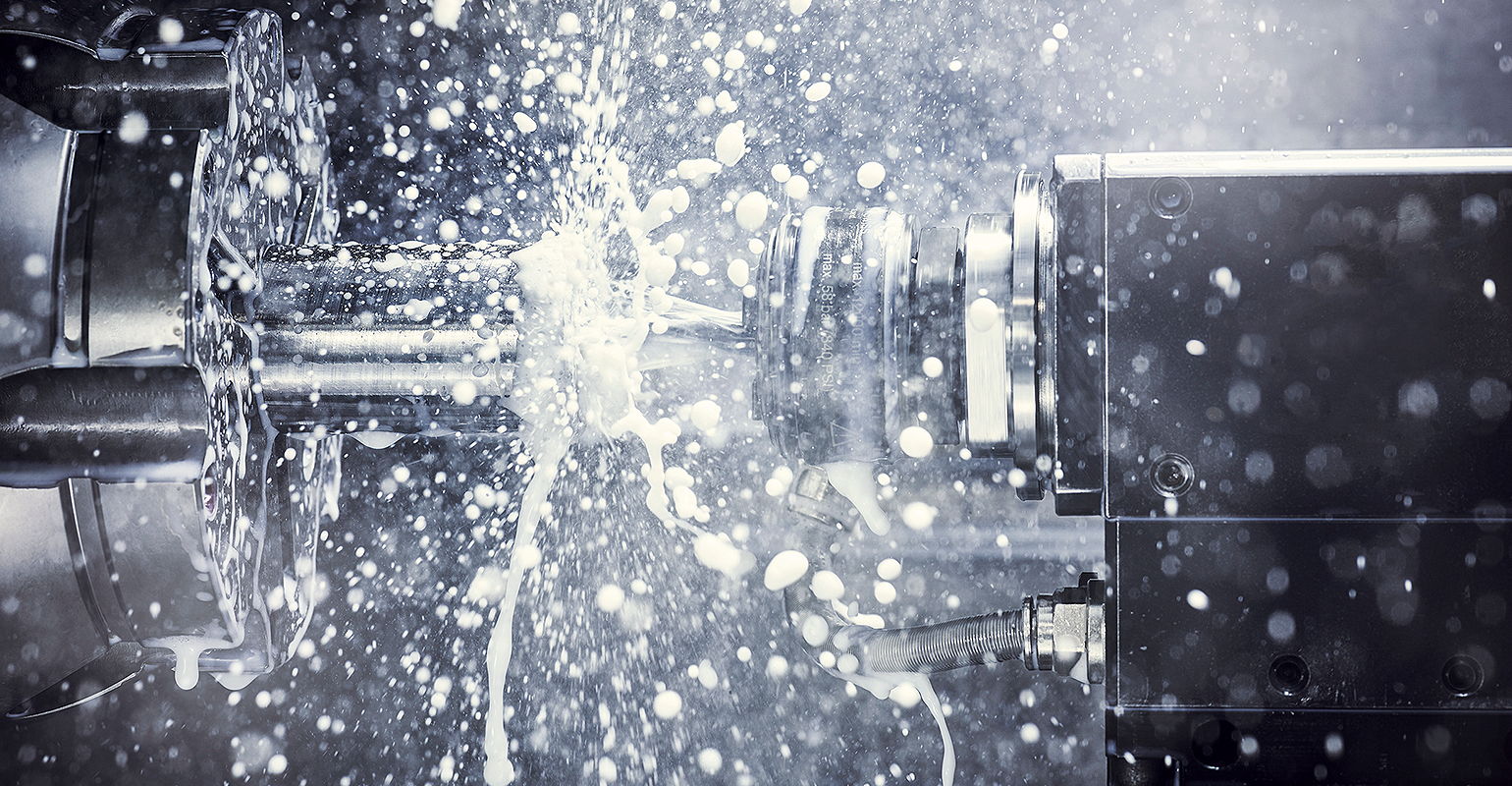

Streaming coolant through the tool tip directly at the cutting zone, evacuating chips and cooling the area without additional peak cycles, makes machining more efficient – and it’s surprisingly simple to achieve.
Many machine shops understandably try to recover the expensive acquisition cost of live-tool machines by saving on options that might seem unnecessary at the time of purchase. One feature that shops might forego is “through-spindle internal cooling”; flood cooling may seem an acceptable, cost-saving alternative.
Most shops would acknowledge though that external cooling (in which coolant is sprayed at the cutting area through a nozzle positioned three to six inches away from the cutting point) is inherently inefficient. Unless the operator has excellent aim, the coolant stream could miss the target entirely, resulting in poor chip evacuation, high tool temperature, and an overheated cutting zone. Even an optimal set-up still results in coolant spray and splatter.
For drilling or deep-pocket machining, flood cooling is particularly ineffective as the stream fails to reach the cutting zone once the tool enters deeper into the workpiece. Then, additional peak cycles are required to evacuate chips and cool the tool head, which makes for longer overall part-cycle times.
In through-spindle internal coolant systems, coolant streams through the tool tip directly at the cutting zone, efficiently evacuating chips and cooling the area without additional peak cycles. And that is a much more effective method of machining.
