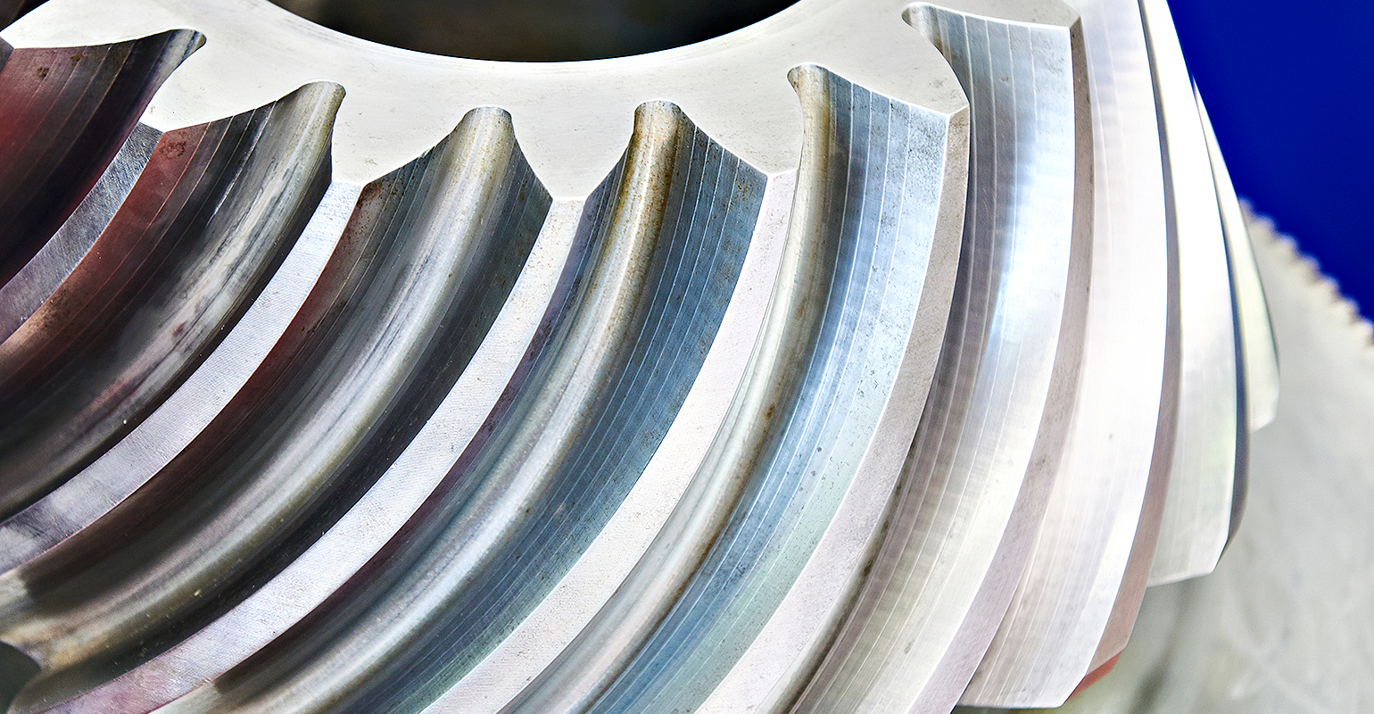

It’s impossible to design a machine part without ‘burrs.’ In fact, it’s only after the part has been designed and a process has been selected for producing the part that any issue involving burrs on the part become apparent. And yet, those burrs have to be removed for the part to function as it’s designed to do.
Experienced part designers have learned that even if a deburring process is included during the manufacturing plan, the possibility of additional burrs developing remains. In many cases, unexpected deburring is needed in a hurry. Until a better solution can be implemented, a temporary hand deburring solution usually works as a remedy.
If you or your team continue to adopt hand deburring as a solution such a situation, then poor finish quality, part inconsistency, a high scrap rate, and employee turnover are likely significant issues for your business. For hand deburring to achieve desirable results, considerable training must be provided. Maintaining a reliable pool of hand deburring workers is tough, and you are always training someone new.

Gear-deburring machines require an operator to set up each deburring tool manually. Early models used individual tools, usually an air tool holding a 3-inch diameter grinding wheel on a weighted, hinged lever. If deburring of simple gears is what you need, those early machines are still effective. However, since such machines generally use only one tool to chamfer gear teeth, the exit burrs need to be filed off using a manual lathe, or a similar method, before this deburring method can be used effectively.
By the 1980s, companies like James Engineering had added as many as four tools to these manual-machine designs, so more tools to be used, resulting in a quicker cycle time. Removing exit burrs using this new manual-machine design was no longer a separate operation. This multi-tool advancement changed everything.
In the late 1980s, James Engineering added its automatic wheel-wear compensation control feature and a unique, raised-gear holding capability that further distinguished its early manual-machine models. Together, these additions made flipping of gears an unnecessary step in the manual-machine finishing process.
Gears could finally be removed from a gear cutter and put onto the James Engineering manual gear-deburring machine. Tool number one is set up manually to remove the exit burrs of the gear. Just a few degrees behind this operation, chamfer tools number two and three can be set up to put chamfers on both sides of the gear. Tool number four, an abrasive brush, can be used to remove the micro-burrs of the chamfered gear teeth, completing four operations and producing a completely finished part in a single cycle.
As the early, manual machine deburring systems gained popularity, people found that each tool took as long as five minutes to set up, test, adjust the set-up, and retest, and then run a batch of parts. These machines would run cycles of 15 to 30 seconds per side for gears measuring six inches in diameter, or smaller. Larger gears might have a cycle time of a minute per side. These types of manual deburring machines are still used today.
