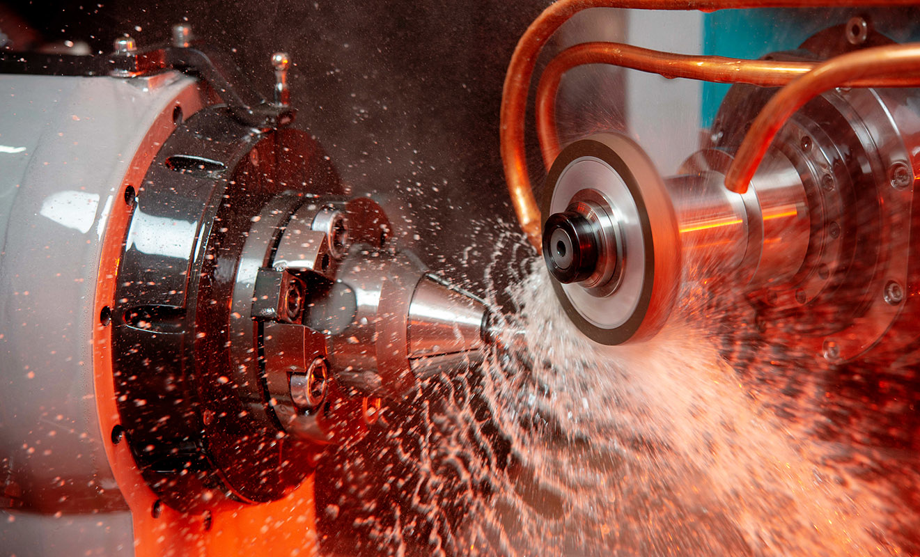

Outside of tooling and materials, the most important inventory item for a machine shop is machine coolants. As the label implies, coolants are responsible for maintaining equipment within an optimal temperature range during operation. Not only does this prolong the machine’s life and keep performance reliable, but it improves machine safety, reduces some related costs, and promotes better productivity and product quality.
The latter is especially true when working with complex materials where precision is paramount for reliable outcomes – such as super-alloys or refractory metals.
Different machines have different, even unique parameters and requirements — including various types of coolants. Machining coolants come in a several forms, each with its own considerations and applications.
Types of coolants
Straight Oils.  Not unlike standard oil, these coolants are thick, concentrated formulations that contain a numerous ingredients — primarily lubricants. Their sole purpose is to provide lubrication for the machining process, to reduce friction, but they also sacrifice some cooling properties to do so.
Solubles.  Water-soluble and cutting fluids offer an excellent middle-ground and are among the most common types of general-purpose coolants. They lubricate and reduce heat, but require more maintenance — fungus and bacteria can grow in a dirty sump.
Synthetics (fluids.) Synthetics are designed specifically for cooling and contain no mineral or tramp oils. This results in a cleaner solution with remarkable cooling properties. The downside is these are not a good choice when lubrication is essential.
Semi-synthetics (fluids.) Offering solid cooling properties — and reliable lubrication via a solution with less oil, less odor and a cleaner experience — you can use semi-synthetics for just about any machining purpose. However, they may not be as effective in extreme situations.

Every machine requires unique care, and it is critical to know how and when to apply the machining coolants and what administration method they need. You can automate the process or do it manually, with the three standard methods being air, mist, and flood.
More modern and advanced machines typically handle the administration process without any manual input. For example, a drill might spray the material with water or machining coolant as it’s doing the work. There’s no question this is a much safer method, but it also can create quite a mess.
