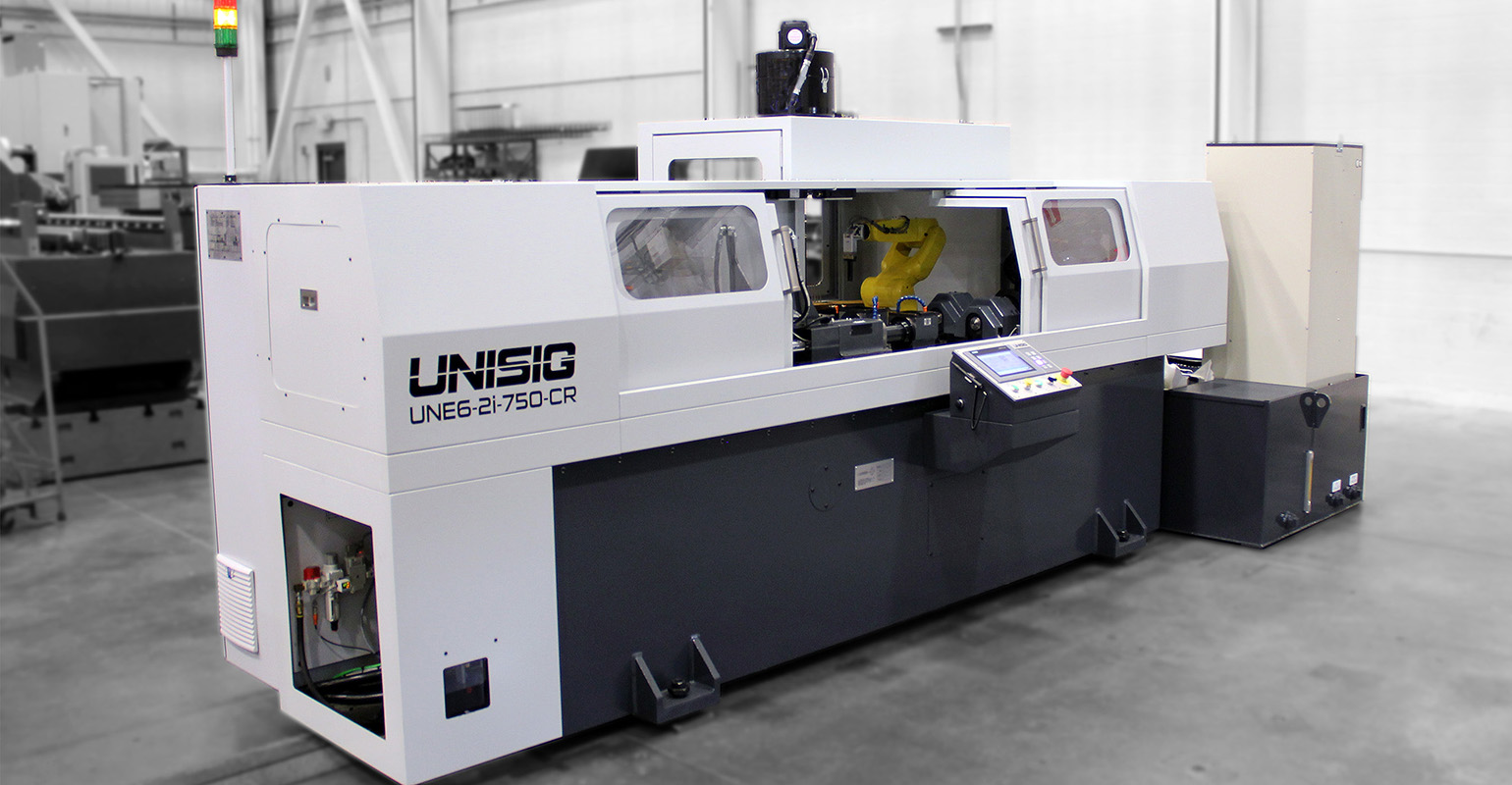

The UNISIG UNE6-2i has two independent, high-speed spindles for production of 10-in. or 30-in. maximum part lengths and available integrated automation onboard.

UNISIG’s IMTS 2022 exhibit – at booth 339159 – will focus on the technologies for extreme depth-to-diameter hole drilling, including the ability to create holes with outstanding precision. The UNE6 Series small-diameter gundrilling machines stand out at drilling deep holes in demanding materials, including high-strength titanium and surgical-grade stainless steel, and achieve superior concentricity through tool and workpiece counter rotation.
UNISIG also will highlight production of medical parts on the UNE6-2i – with two independent, high-speed spindles for production of 10-in. or 30-in. maximum part lengths and available integrated automation onboard. The machine's high accuracy allows it to drill hole diameters from 0.03-0.25 in. (0.8 mm-6 mm) and depth-to-diameter ratios from 20:1 to more than 100:1 in workpieces up to 11 lb (5 kg).
With 28,000 rpm total drilling speed and a 3,000 psi (207 bar) flow-based coolant system, the UNE6-2i combines exceptional process control with an intuitive smart control interface.
