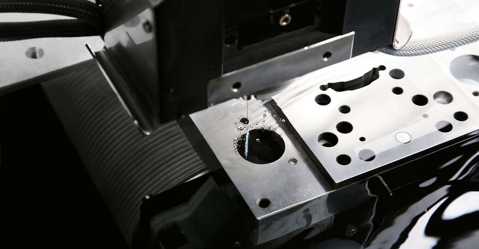

With Intelligent Power Generator (IPG) technology, the CUT P 350 Pro delivers surface finishes as smooth as Ra 0.08 µm and heightens accuracy with integrated thermal regulation that maintains temperature at ± 0.2°C. To accommodate heavy workpieces, the machine’s QUADRAX® mechanical system keeps the table, work tank, and dielectric liquid stable.
Capitalizing on more than a century of EDM technology, the CUT P 350 Pro and CUT X 500's new Uniqua human/machine interface (HMI) delivers optimal functionality and ergonomics in a 19-in. vertical touchscreen, full keyboard and mouse. Abundant automation options add to the machine’s scalable flexibility, with optimized production for electronics, automotive, medical and mold and die manufacturers through more than 600 pre-programmed cutting processes.
The AgieCharmilles CUT X series holds extreme accuracies in machining positioning and pitch. Developed to provide high precision and thermal stability in large runs of complex components, including stamping tools, multi-cavity molds and micro components, the CUT X 500 and all other CUT X machines feature adapted mechanical structures, dedicated machine calibration and testing to deliver pitch accuracy as low as 1.0 µm. High-precision axes, short measurement loops, dual measurement on all axes, consistent isolation of the EDM area from heat sources and submerged working areas optimize conditions for micro applications. Two-spool Automatic Wire Changer technology and an onboard Job Management System help further reduce processing time and simplify job prioritization.
