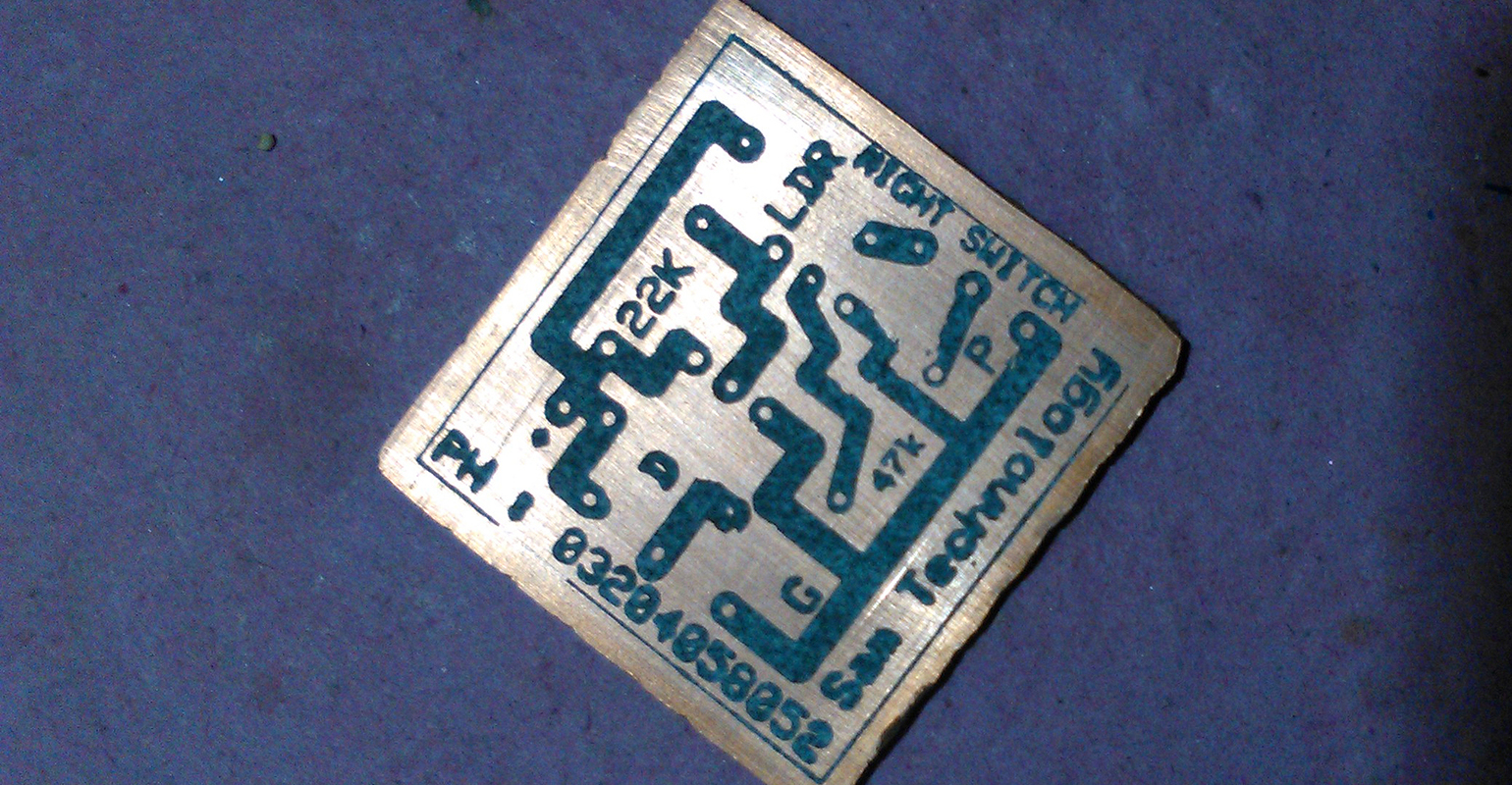

The photochemical machining (PCM) or photochemical milling process uses photoresist imaging to place a pattern on top of a metal workpiece. This pattern is then used to invoke selective corrosion, thereby efficiently removing areas of the component or product and shaping it as desired.

2. Create the photo tool. Next comes creating the overlay for photoresist imaging. This begins with a CAD drawing which, when finalized, is printed onto the photo tool made from polymeric film.
This step includes undercutting. The photochemical process’s footprint will be larger than the intended pattern when it takes effect. Therefore, the digital drawing and photo tool must be larger than the targeted size to achieve the correct dimensions.
3. Laminate the metal. Step three involves coating the sheet metal with photoresist film. This polymeric layer is where the photo-sensitive materials and photo-initiators are located.
4. Print, expose, and develop. The image from the CAD drawing – the photo tool with the desired shape – is transferred onto the sheet-metal workpiece, which remains coated with photoresist film. This step involves applying UV radiation. The photoresist film commences a chemical reaction where any portions of the sheet metal not protected by the photo tool undergo polymerization.
As promised with the comparisons to photography, this is the step during which the patterned metal is “developed.” The areas that have not undergone polymerization in the previous stage have become softened and can be washed away with an alkaline solution. The rest of the pattern is unaffected, which leaves the newly shaped workpiece behind.
5. Etching, stripping, and inspection. Lastly, etching – the process of removing the softened metal – takes place. Specialists apply an etching solution using a chamber and spray tools. It reacts with the metal at the atomic level to quickly dissolve the weakened material and leave behind the desired “developed” portion of the pattern.
The final step, stripping, involves applying another alkaline solution to remove the photoresist film from the surface.
