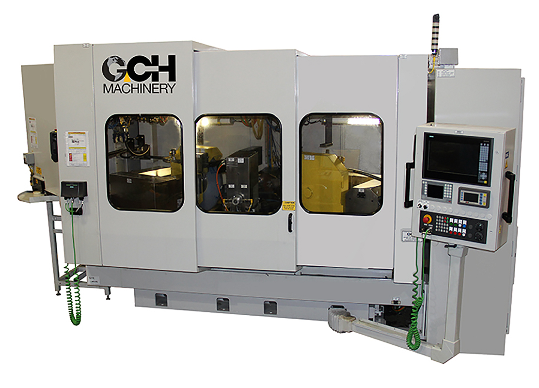

GCH Machinery applied more efficient power and better environmental controls, so the fully automated dual-head grinder can process two sides of a part simultaneously.

The fully automated grinder, with two separate and independent grinding wheel spindles, can process two ends of a transmission part simultaneously to avoid the need for a second grinder. Also, the machine’s ability to process specific sections of the part at the same time promotes greater part accuracy, which is critical to any transmission.
“We took an older machine that wasn’t able to hold size and was difficult to keep in operation due to its many older components, and retooled it for two brand-new EV parts,” Geddes explained. “The automated turnkey system produces parts that meet the automaker’s tight tolerances.”
Other new features of the remanufactured grinder include updated electrical controls, an internal robot, an in-process part gaging system, an HMI touch screen, a wheel balancer, an automatic part de-oiler and new lubrication, pneumatic and electrical systems.
In addition, the rebuilt grinder meets all of the automaker’s green standards as well as the safety standards established by the UL – the global safety-certification agency.
