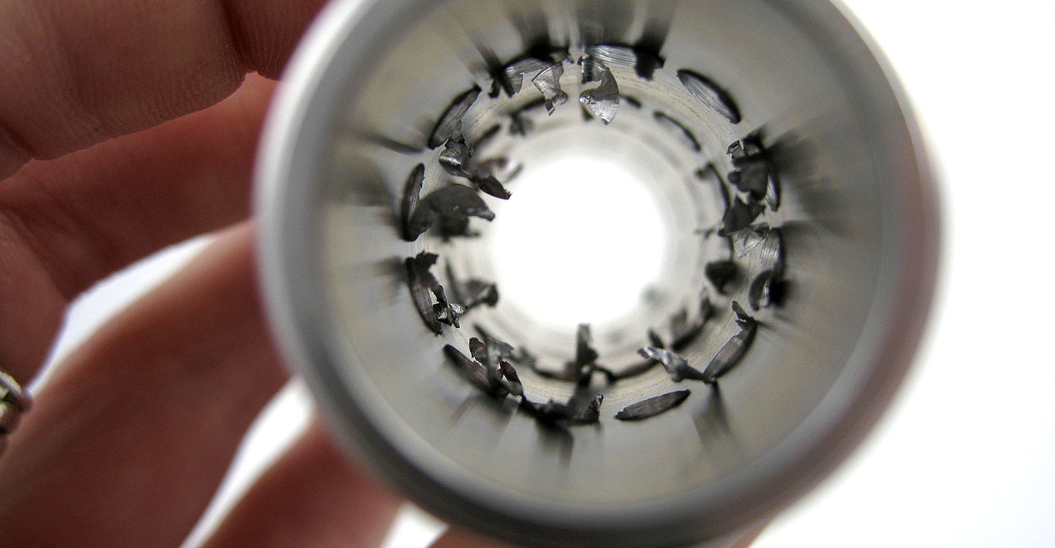

It doesn’t matter if you’re cutting parts with a handheld plasma torch or a precise laser. Some edges will come out dangerous or rough. Sometimes, burrs, sharp edges, and minor defects can occur, especially in cross-drilled holes. Even with the best equipment on hand, those defects can be challenging to remove — even more so if you’re trying to be cost-efficient.
That’s a spot for cross-hole deburring, a reliable surfacing and finishing technique that helps remove blemishes and defects, like burrs. When it’s implemented as an autonomous process, it’s called integrated deburring.
