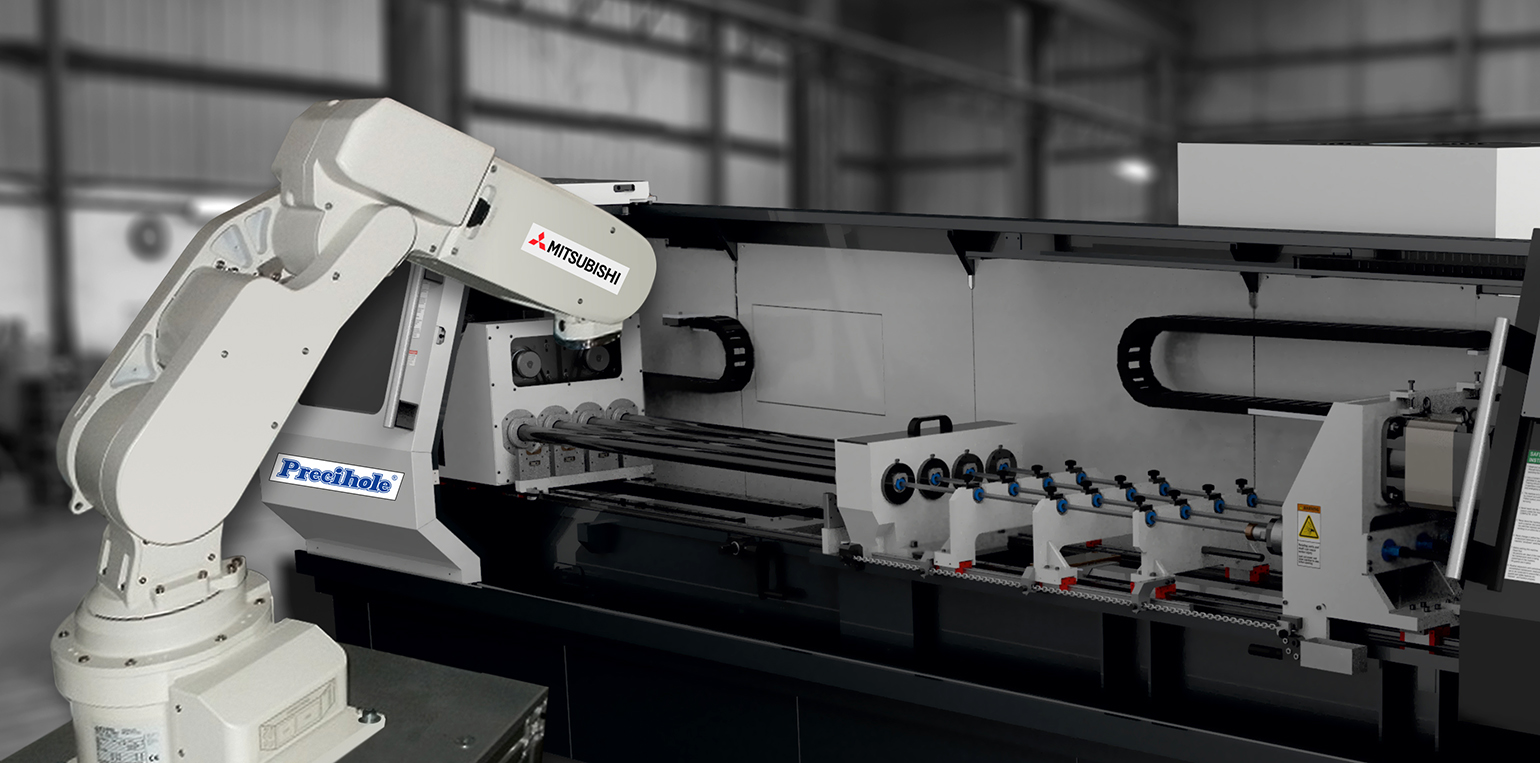

Machines and production cells perform deep drilling, reaming, and rifling for as many as 20,000 small-caliber firearm barrels per month – efficiently.
ABSOLUTE MACHINE TOOLS’ portfolio of machine tools and automation systems includes machines specifically engineered for drilling, reaming, and rifling of small-caliber gun barrels. These Precihole brand machines can be combined into processing cells so a manufacturer can drill, ream, and rifle as many as 20,000 small-caliber firearm barrels per month -- efficiently.
A typical cell is comprised of three machines. First, Precihole’s four-spindle gun-drilling machine permits deep drilling of four barrels simultaneously. An open machine configuration facilitates robot access, minimizing operator involvement and supporting 24/7 operation. Depending on individual model configuration, the machine can drill IDs from 0.04 to 1.57 in. and barrel stock from 0.4 - 4.0 in. OD.
Next in the process is a two-spindle pull-reaming machine that features automation for insertion and repositioning of reamers. Reduced set-up times and rapid operating parameters (0-20 IPM pulling speeds) support high-volume barrel finishing and polishing. Different machine configurations handle reaming diameters from 0.15" to 0.59" and depths from 24" – 60."
Finally, Precihole’s button-rifling machine forms precise barrel grooves at speeds up to 80 IPM. Depending on the machine model, rifling size can range from 0.15 - 0.59 in., and depth from 24 – 60 in.
