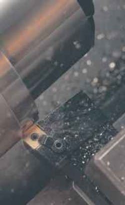

In machining ductile iron, Carboloy's TX150 turning-grade insert improves tool life, while resisting deformation and edge chipping.
