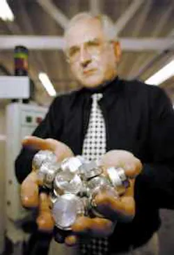

Jackson Corp.'s director of operations, Sydney Cap, displays completed end caps after reducing the cycle time for two caps from 2 min to 95 sec.

After running the lathe for several months, it was decided that live tooling was the answer to the secondary process problem. Haas engineers were brought in to work with plant personnel to add live tooling to the lathe. "It worked great. With the live tooling option, we eliminated one operation and all the additional handling," states Cap. "Each overhead closer needs two end caps, which used to take two minutes of machine time and two operations. Now both operations are done in 95 seconds on a single HL-1 lathe. We face it, turn the O.D., thread, groove, drill offset holes, tap, and cut off. It goes in as an aluminum bar and comes out as a finished component." Warden believes the HL-1 lathe equipped with live tooling is giving them the potential to grow. In order to reach the goal of 900 over-head concealed closers a day, 1,800 end caps need to be completely machined each day. This translates into 600 per shift with a three-shift schedule. To meet the challenge, the HL-1 is equipped with a chip conveyor and has been teamed with a CNC Enhancements automatic barfeeder with a rack capable of holding 12-hr of stock.
